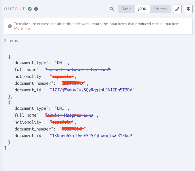

This is the correct output when executed independently

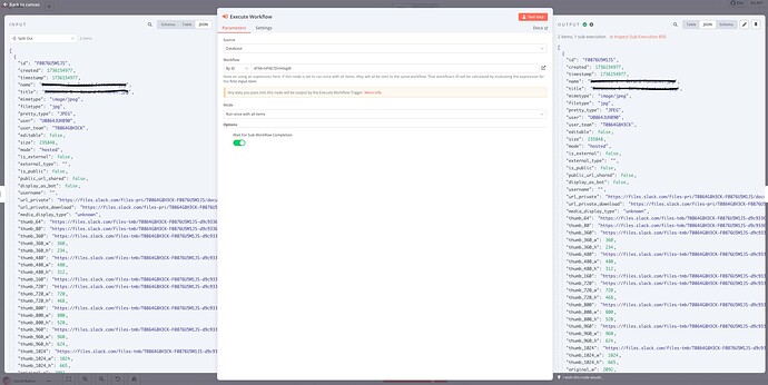

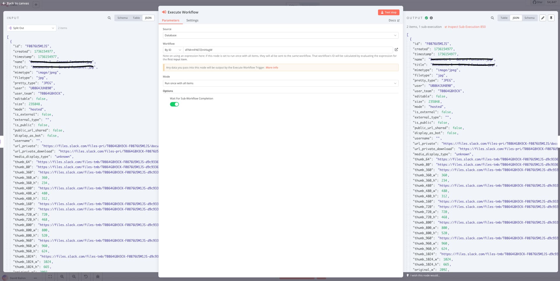

As you can see in the screenshot below, the output is simply a copy of the input. Also, the execute workflow node that calls this sub-workflow is configured to “Run once with all items” and has “Wait For Sub-Workflow Completion” option enabled.
Regarding the recognition approval loop, the workflow functions correctly regardless of whether the loop is present or not, as long as the Slack node is removed. I’ve tested the following scenarios:
  • Without Slack, with loop: Works correctly.
  • Without Slack, without loop: Works correctly.
  • With Slack, with loop: Fails (returns input data).
  • With Slack, without loop: Fails (returns input data).
  • With loop and a dummy node instead of Slack: Works correctly.
Any suggestion?
