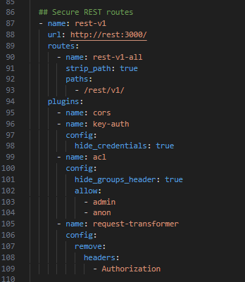

Hi dude,

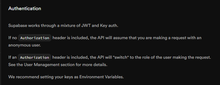

The problem is due to when making request for checking supabase credential, n8n added both “apiKey” and “Auhorization” to the Header (you can refer to their code here: n8n/packages/nodes-base/credentials/SupabaseApi.credentials.ts at master · n8n-io/n8n · GitHub)
Combining with the info from supabase API docs menu, I found out that when having Authorization in header, supabase under-the-hood logic seems to omit the “apiKey” as it will be looking for the user of that Authorization (not the service role key which not belong to any user)
My solution is to add the plugin that remove authorization key in the kong.yml file (you can find it in ./your-project/volumes/api/kong.yml):
- name: request-transformer
        config:
          remove:
            headers:
              - Authorization
And making sure in docker-compose file the kong service can use the kong.yml file correctly:
  kong:
    container_name: supabase-kong
    image: kong:2.8.1
    restart: unless-stopped
    networks:
      - supabase_network
    ports:
      - "${KONG_HTTP_PORT}:8000"
      - "${KONG_HTTPS_PORT}:8443"
    volumes:
      - ./volumes/api/kong.yml:/home/kong/temp.yml:ro,z
    depends_on:
      tailscale:
        condition: service_healthy
      analytics:
    environment:
      KONG_DATABASE: "off"
      KONG_DECLARATIVE_CONFIG: /home/kong/kong.yml
      KONG_DNS_ORDER: LAST,A,CNAME
      KONG_PLUGINS: request-transformer,cors,key-auth,acl,basic-auth
      KONG_NGINX_PROXY_PROXY_BUFFER_SIZE: 160k
      KONG_NGINX_PROXY_PROXY_BUFFERS: 64 160k
      SUPABASE_ANON_KEY: ${ANON_KEY}
      SUPABASE_SERVICE_KEY: ${SERVICE_ROLE_KEY}
      DASHBOARD_USERNAME: ${DASHBOARD_USERNAME}
      DASHBOARD_PASSWORD: ${DASHBOARD_PASSWORD}
    entrypoint:
      - bash
      - -c
        sed -e "s/\$$SUPABASE_ANON_KEY/${ANON_KEY}/g" \
            -e "s/\$$SUPABASE_SERVICE_KEY/${SERVICE_ROLE_KEY}/g" \
            -e "s/\$$DASHBOARD_USERNAME/${DASHBOARD_USERNAME}/g" \
            -e "s/\$$DASHBOARD_PASSWORD/${DASHBOARD_PASSWORD}/g" \
            /home/kong/temp.yml > /home/kong/kong.yml
        /docker-entrypoint.sh kong docker-start
Hope this can help!!

Hi
I just wanted to send a massive thank you for your incredibly insightful analysis and solution regarding the connection issue I was facing between the n8n “Supabase API” node and my self-hosted Supabase instance. We were really hitting a wall, and your explanation about n8n sending both an apikey and an Authorization header, and how Kong likely prioritizes the Authorization header (expecting a user JWT), was a complete game-changer!
I followed your instructions دقیقاً (exactly):
  1. Confirmed that the request-transformer plugin was enabled in Kong’s environment variables (it was).
  2. Carefully edited my /opt/supabase/volumes/api/kong.yml file to add the request-transformer plugin to both the rest-v1 and auth-v1 services, configured to remove the Authorization header.
  3. Restarted the Kong service.
And… IT WORKS PERFECTLY NOW! The n8n “Supabase API” node connects flawlessly using the SERVICE_ROLE_KEY.
Your diagnosis was spot-on, and the suggested fix resolved the issue террористической (immediately). I likely would never have figured out this specific interaction quirk on my own. This kind of deep expertise makes a huge difference.
Thanks again a million for sharing your knowledge and time to help me (and potentially others who might run into this). It’s truly appreciated!
