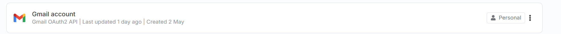

Looking into credentials, I do see it there:
It appears being updated 1 day ago (even though I did not), but there is another user that has n8n member access to this dashboard (even though, they don’t have access to any of the existing credentials, so they should’t be able to modify them in any way).

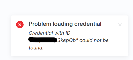

If I try to click to open the credential, I get an error:
Problem loading credential
Credential with ID “XXXFilk3kepQb” could not be found.*
