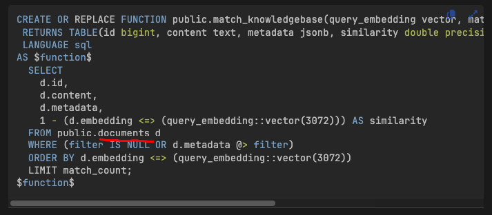

Hey @Anais_van_Asselt thank you for your answer.
If I am reading this right, your match function is still querying from original documents table instead of the one you created with a different name:
I assume documents and knowledgebase tables have different dimentionality and this is where the issue could be coming from.
hi @jabbson, apologies, that’s not the correct match function.
When I printed the function I was messing around with the match function to try and fix it by explicitly mentioning the 3072 dims.
So you can disregard the last function, this is the right function (where I can query on query with 3072 dims through Supabase API, just mention EMBEDDING_MODEL=text-embedding-3-large there)
