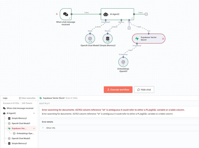

When I try to query the ai agent about the content of my vector database, the following erro pops up “Error searching for documents: 42702 column reference “id” is ambiguous It could refer to either a PL/pgSQL variable or a table colum”

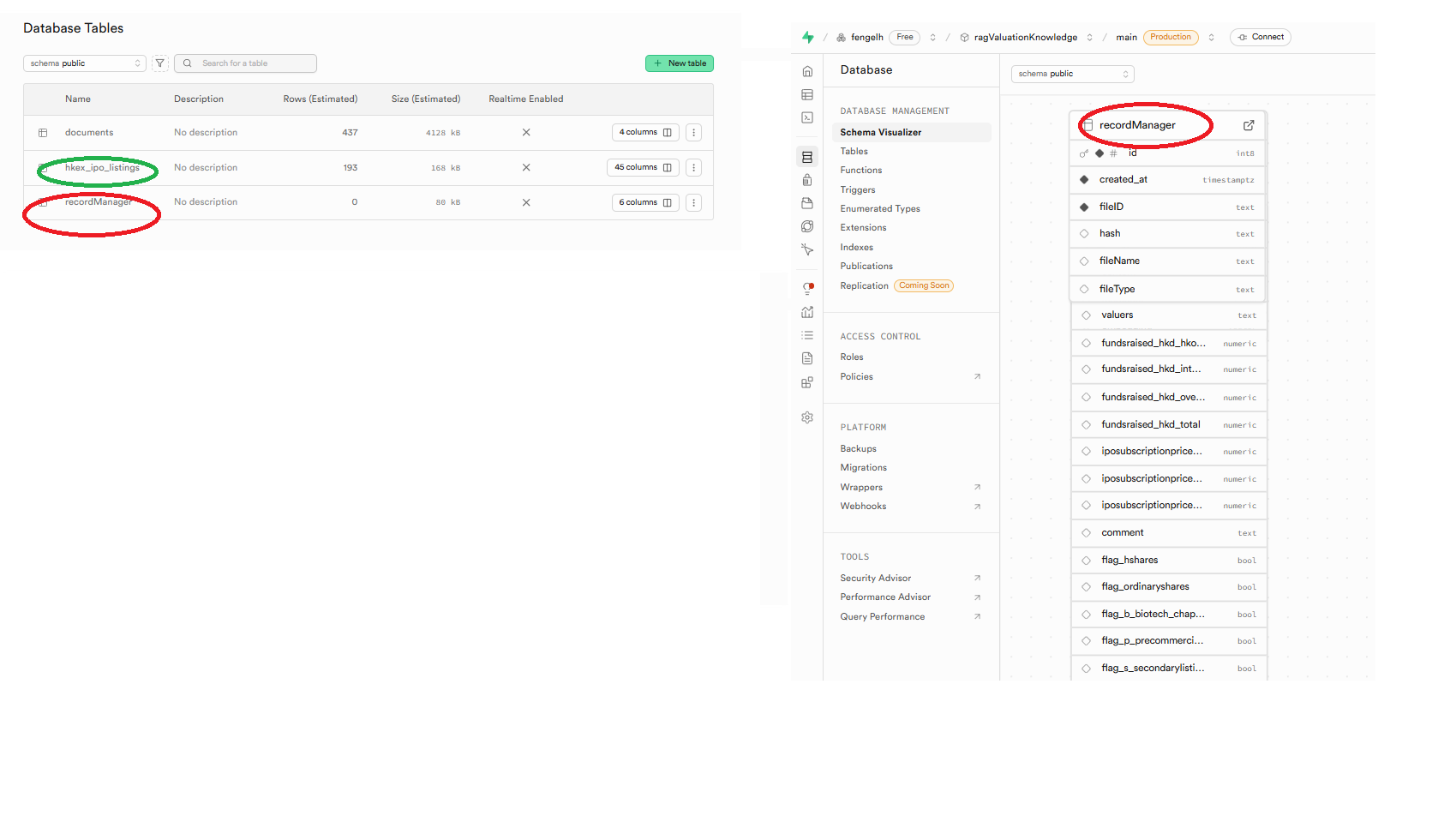

I sitll cant shake of the feeling that the issue is with my Supabase setup, because i used this projects for a few tests and the tables have been repurposed a few times. So, while my checks above are ok, there are a few things that seem odd:
  • when i ask supabase ai help to confirm the tables dimensions are 1536, it says it doesnt find the table.
  • also, from the 3x tables that i have in supabase for the the project, only 1x shows up in the schema visualizer . I feel like there should be 3x seperate schemas for each table?
Maybe I should setup a new project and re-do everything - what do you think? If the recommendation is to re-start, does someone do you maybe have a good tutorial on youtube or other learning mateiral for best practice for Supabase setups, so that i can avoid such a mess in if i should re-setup everything (youtube mainly has a lot of 20min intros which i have got done)?

Error 42702: Column reference ambiguous is usually resolved by renaming columns or parameters in your PL/pgSQL function to avoid name conflicts. The Supabase Vector Store node ignores the “Table Name” field and always uses a function that references the documents table, so you must either align with that name or adapt the function manually. Whether you use documents or a custom name, your PL/pgSQL function must be consistent and without variables that cause name ambiguity.
You should review and correct the match_* function in Supabase.
Make sure your functions — such as match_hkex_ipo_listings or match_documents — do not have ambiguous names. This requires prefixing parameter or column names to avoid collisions and using explicit aliases, for example:
SELECT c.id,
FROM hkex_ipo_listings c
WHERE c.id = match_hkex_ipo_listings.id_param;
Renaming as many variables as possible to avoid duplicating common names like id, content, etc.
Thanks Erick! This fixed that particular error, but now another popped up - i will mark your reply as ‘solution’, but allow me to share that new (but related) error here with you (i know technically I should start a new post, but i have been going in circles on this for days now).
