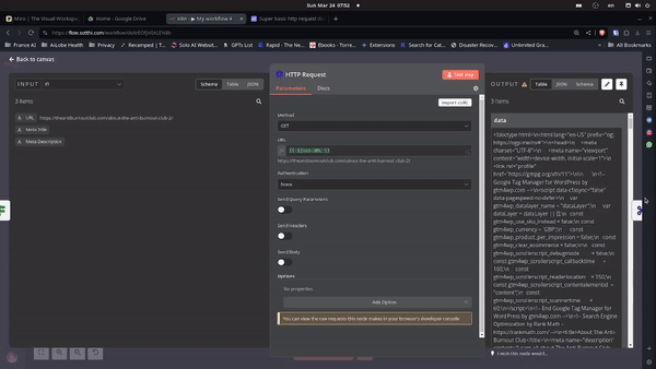

I know it is super basic; but
my http request only work when I hard code the URL itself and does not with: {{ $json.URL }}

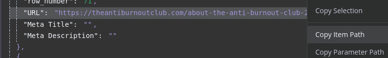

ok I almost figured it
by using the item path
but how I could make the
{{ **$item("0")**.$node["If"].json["URL"] }} dynamic so it loop into each line
Hmm, it seems to work as expected for me - what exactly is not working for you?
I assume you receive multiple items from the Google Sheet Trigger node and not all of them have a valid value for URL set. So the HTTP Request node works for some (the ones that have a valid value) but fails for the one(s) that do(es) not.

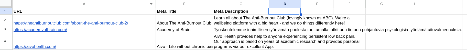

in my test I have 3 new rows
- I added another IF to filter if NO URL, because when I add a blank line it was breaking the flow
my issue is the result of item (“0”) which is the first new row
is copied into row 2 and 3
I did try with a loop, but no luck

here a sample shared publicaly with editor right
my actual workflow which point to the sample sheet
with an example of the desired result
Are you experiencing the same error? For me, everything is working fine
To be clear. If you filter out empty ones {{ $json.URL }} should work totally fine.
- Yes I filter the empty line without URL) at the 1st IF
Please switch from “Schema” to “Table” view. There you will then probably see that there are 3 different URLs. Then try each of the one by one, and I assume one of them will result in exactly the error you are seeing.
