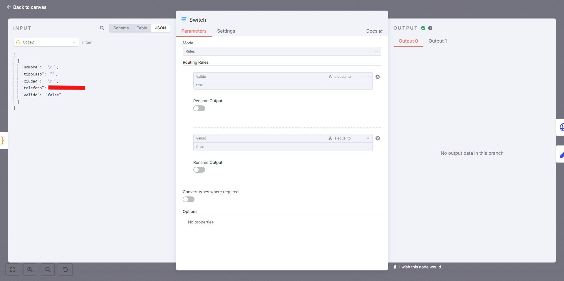

Switch node not matching string value "false" in n8n
:receipt: Context:
  • I’m using a Switch node in n8n to check a valido field that is a string, either "true" or "false".
  • The input is: "valido": "false" (confirmed).
  • The Switch has a rule comparing valido == "false" (text, icon A is shown).
:cross_mark: The problem:
Despite valido being "false", the Switch node does not activate any output branch. Output 0 and Output 1 are empty.
Can you share a screenshot or JSON output of the data going into the Switch node?
Check if the "valido" value definitely a string, not a boolean false.
I think what you can do is, instead of using a plain text rule, try using an expression in the Switch node:
{{$json.valido === “false”}}
This may check if the value is exactly "false".
i’ve forgot to write : {{$json.valido}} , pero thanks Abrar_Sami
Now it works
