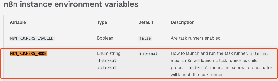

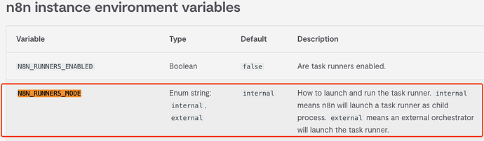

Based on the documentation Task runners | n8n Docs, default n8n task runners are internal (as child processes) if we don’t specify N8N_RUNNERS_MODE=external, so technically there’s no need to define separate runner containers.
And setting N8N_RUNNERS_ENABLED=false fixes the issue, but only temporarily because it’s being deprecated and in the next versions of n8n the standard and only official way of working is with task runners enabled.

@King_Samuel_David The last reply from the original poster already explains that he is not using N8N_RUNNERS_MODE=external. There should not be any need for additional containers when using the default N8N_RUNNERS_MODE=internal setting. Also, the thread to which you linked was related to Queue mode and Workers, not Task Runners. These are two different things.
