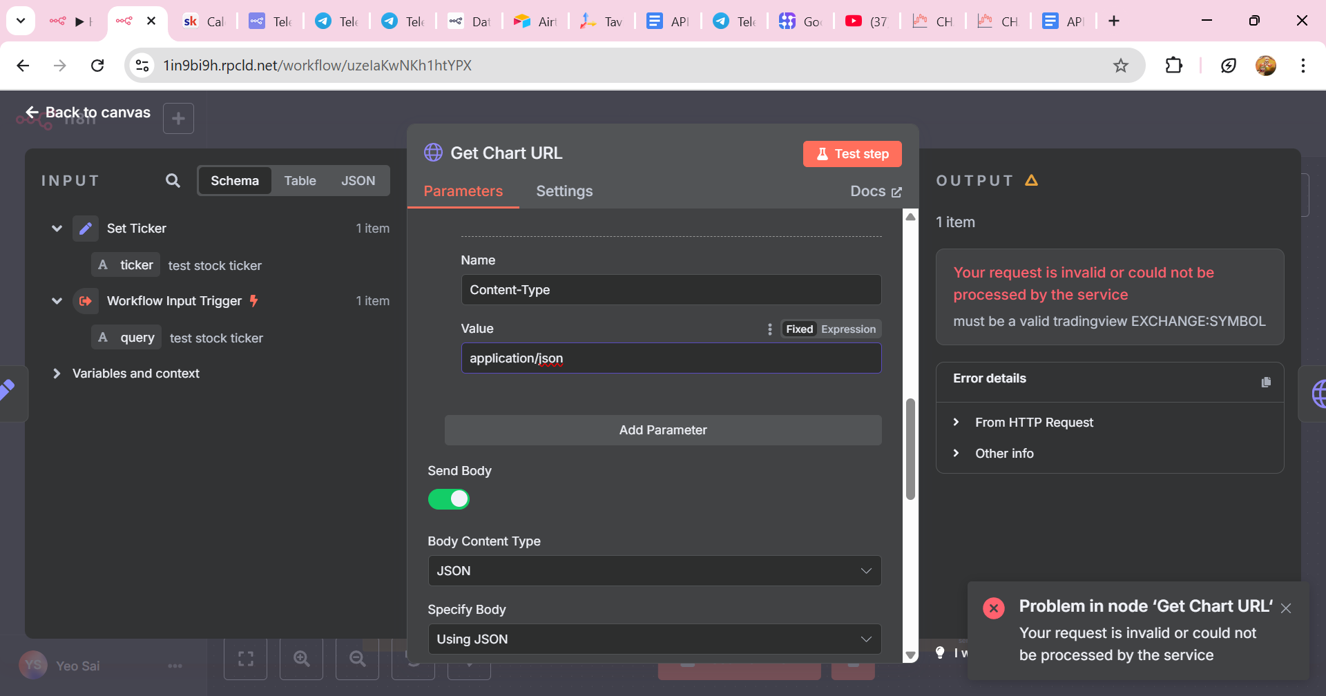

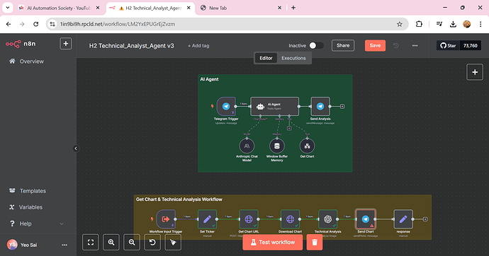

I have a workflow for analyse the share. i get stuck on the send chart module.
See the above image the red box highlight where my error is.
i am not sure what to fill in the parameter : -
Can some one tell me , chart ID what info i need to fill in ?
Thank you
Paul
The chat ID is wrong, apparently.
Try to get the chat ID from the trigger and send it to the Sub-workflow.
Do you know how to do that or do you need help?
You can also write the chat ID in simple text. To find out the chat ID you can use this bot;
@solomon

May i know Where can i find the sub-workflow from below diagram ?

Below is my workflow
Chat ID

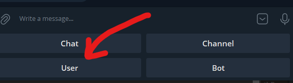

So the first thing you need to do is get the ID of your own user:
Choose this option in IDBot and find yourself. This way the bot will be able to message you.
Another option is to create a channel with your bot and use the channel ID instead.
Credentials

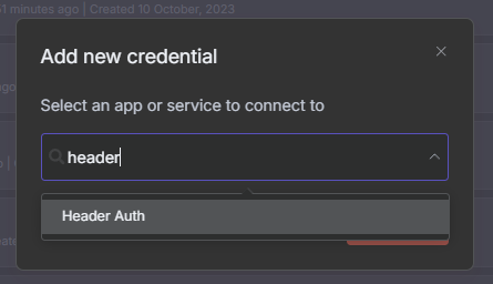

The other thing you can do is to create a Header Auth credential to safely use your API key.
Execute workflow fields
Lastly, adjust the fields you are going to accept in your subworkflow, so you always have the same field name and you can also instruct the AI in a easier way.
Final result
I’ve made some extra adjustments to make it easier for you. Including some small tweaks to your prompt to simplify and get more consistent results.
You can copy and paste everything, if you’d like:

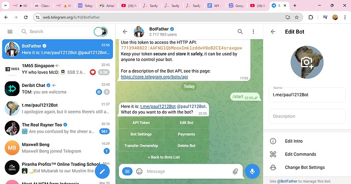

you mention the first thing i need to do is get the ID , i am not aware how to go to User button ? As my telegram i can only see below info :-
Paul
Have you seen the link I provided for the IDBot?
This is the IDBot: Telegram: Launch @username_to_id_bot
The one in your screenshot is called BotFather, not IDBot
@solomon

I have one question , When i set up credential for chart-IMG API , the name i must use x-api-key , if i try to change to api-key , it will appear credential issue, when i watch some you tube video , they enter Authorization.

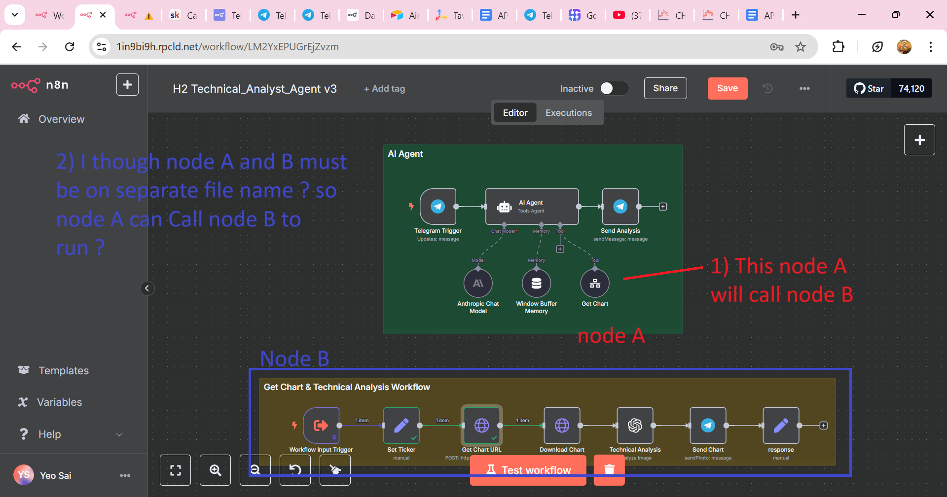

question , refer to below image , the node A and node B workflow , are they allow having same file name , how node A call node B ?

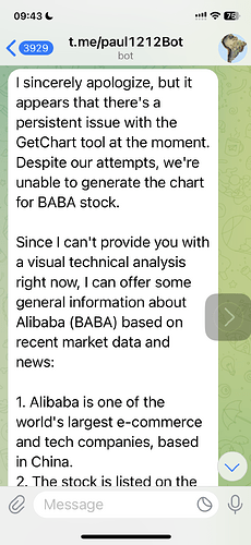

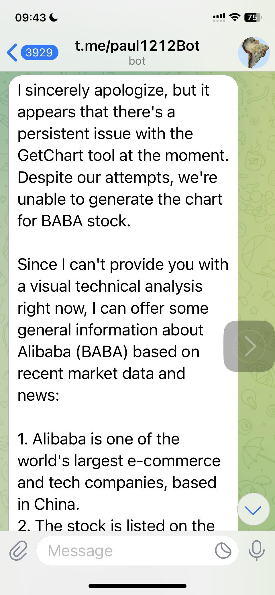

question:- the workflow you share , it is every time can display chart ? Mine alway unable to display charge and no error .

Credentials
This is a Header Auth credential. The service that receives the request decides the name of the header field where the key should go. Some services use "Authorization", others use "key"etc… It depends on how the service is set up.
Node A, Node B
That is a sub-workflow. See documentation here.
They can be in the sabe workflow or a separate one.
You can have only 1 trigger for “Execute on called by another workflow” in your workflow. So if you decide to have multiple sub-workflows, each sub-workflow will its own file/workflow.
Chart Error
Check your executions to understand why the subworkflow is giving an error.
Do you know how to check your executions?
