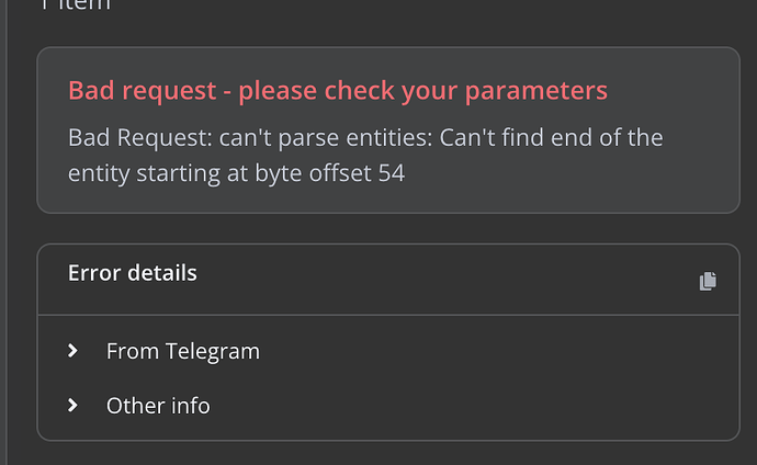

I’m running into an issue with the Telegram node in n8n. Here’s the error I’m getting:
“Bad request - please check your parameters. Bad Request: can’t parse entities: Can’t find end of the entity starting at byte offset 1023.”

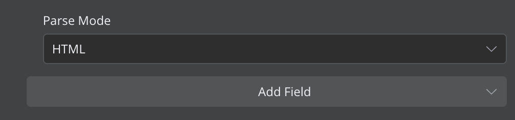

I fixed that after spending 2 hours…
  1. Add Field
  2. Select " Parse Mode"
  3. Select HTML or Markdown2
it worked. Thanks
