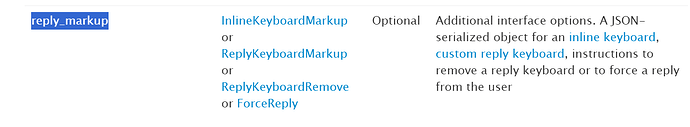

Well, I’m using “N8N 1.54.4”. The problem is as simple as I have told earlier. Let me try to say it with some other words: There is a Method on Telegram Bot API called “sendDocument” and one of its optional paramenters is called “reply_markup” where you can use an “InlineKeyboard”. So, in the specifc Telegram Node for “sending documents” I could not use those options, it simply does not work. The Node send the Document, but does not allow using the “inline keyboard”.

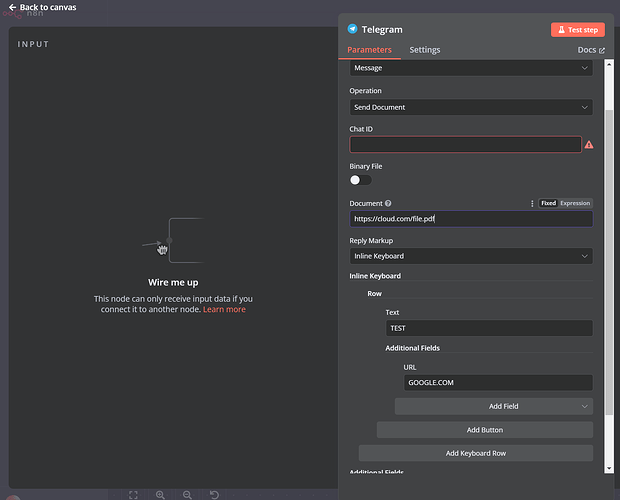

I also can’t remember the error I got at the time, but it did not allow me to use inline keyboards. You could try just by adding a Telegam Send a Document Node and try it.

If I disabled “Binary” and simply send a file_id, the “Send Document” worked and Inline Keyboard showed up.
