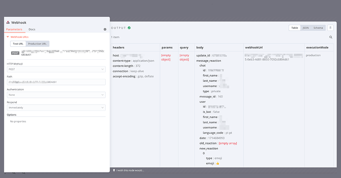

Thanks. Yes, I mean the first option. Do you know how to do it with webhook ?
I’ve replicated this:
On app:
n8n:
See if this is what you are looking for.
Super thanks for your response and help @Canato.
However, to make it work we need to set other parameters in the telegram webhook.
Look for this response if you have such a problem:
When I set it up using postman, it started working.
Thanks to the entire community for helping ![]()
Yeah, the URL parameter was on my second step, missing the allowed_updates parameter.
