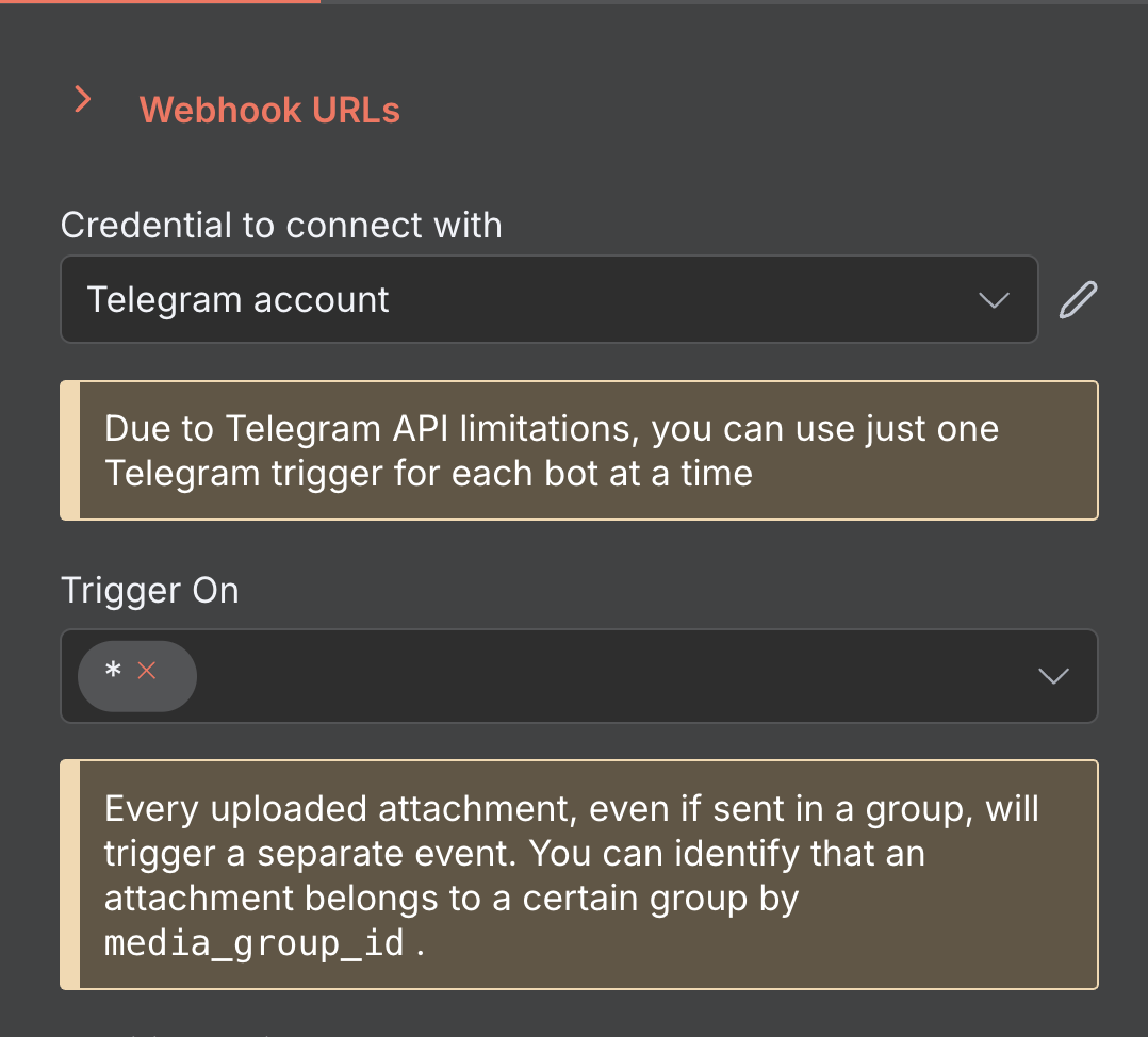

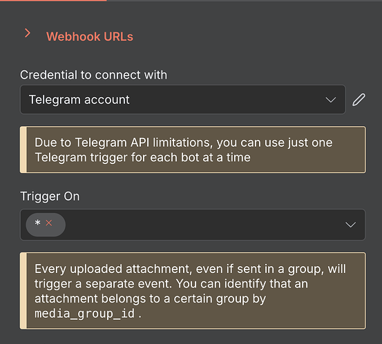

Telegram Trigger works after change in n8n node trigger by * (all), only use message trigger return error, first insert a trigger by message after insert another trigger with * all, start workflow, enjoy.

Changed the “Trigger On” event in the Telegram Trigger to:
  • All updates
This worked for me, thanks :folded_hands:t4:
