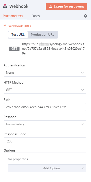

It is also worth noting that not all triggers work the same so the GDrive trigger is polling based and doesn’t need the correct URL. Could you add a webhook node a workflow and see what the URL is for that as well?
Sure thing. Webhook:

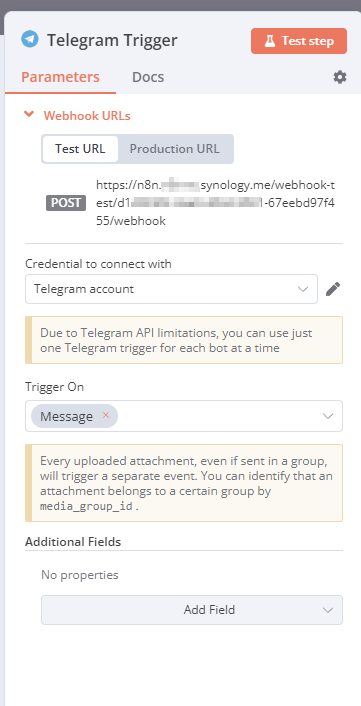

Telegram:
Sending Messages also works, just receiving one as a trigger doesn’t seem to work.
It shows the proper URL I would say?
Assuming that is the URL for your n8n instance that would indeed be correct, Are you trying to run n8n in queue mode at all?
