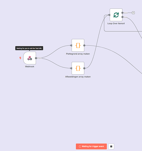

I want to test my workflow with the test URL. I use a wordpress elementor form to trigger the test and it worked fine for the last 2 weeks. But now it doesn’t work anymore.
The webhook is stuck on ‘waiting for trigger event’

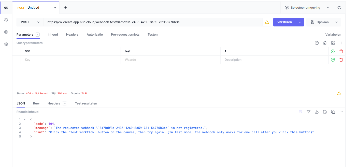

The UI is stuck and I can’t stop the request. When i test the webhook in hoppscotch it gives me this error:
The links are all correct and it should work, but it doesn’t for some reason that I can’t figure out.
When I test the production URL it works just fine as before, that only means I can’t debug anymore.

Hello, @Joris_van_Aken !
Just to explore all possibilities, did you try duplicating the workflow to see if using a different URL makes a difference?
Hi, i just made it work by creating a new project and copy pasting my entire workflow, i dont know why it works. but it works…
