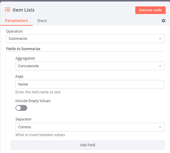

You can do that with the Item Lists Node.
Lets assume the data you want to concatinate is in the property “Name” then the settings would be:
