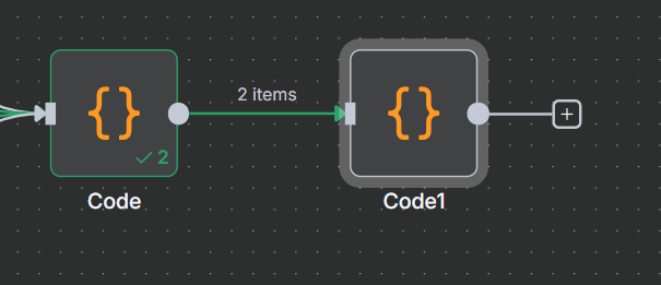

It says 2 items here

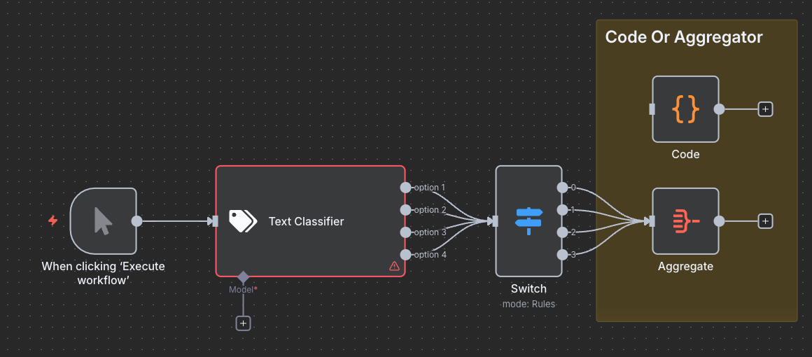

Second Option (Not sure): Have you tried using a switch node right after the classifier? E.g, If (Option 1 From classifier) → Exists → Continues with that data. Although it’s blurry when I think about it, it may be an option.
Not sure I understand where you are going with the Switch Node?
What I meant is;
You said that the workflow gets stuck because the Code node is expecting the rest of your options. So I was wandering if it would still get stuck if you attached a Switch node to the classifier before this Code node.
And the rules is something like ‘(option1 → exists )’ This is what I was wandering if it would work. Because in theory this node would use the options that exist and pass them through the data flow.
Edit: The Webhook method seems more reliable.
yes but it can habe multiple outputs which means it will output 2 items from there on… so I would have to create a logic within the switch for every scenario if that even works since it gets 2 items as inputs - so that wont work.
Try Webhooks. It seems more logical to use a time limit at this point. One minute is more than enough for the AI to generate the right output (Even when all options are included).
Thanks but how should this be a solution to something like this. I mean thing this bigger. Think we have 15 classifications and I allow multiple selections this isnt a solution either since its way too complex…
I mean the code:
return [{
  json: {
    ...items[0].json,
    branch_name: $input.params.categories.categories[$prevNode.outputIndex].category,
    output_index: $prevNode.outputIndex
this code works if I set it to allow only one to be true. it outputs the correct branch only… but when multiple are selected it seems to not be able to handle 2 items together in this case.
