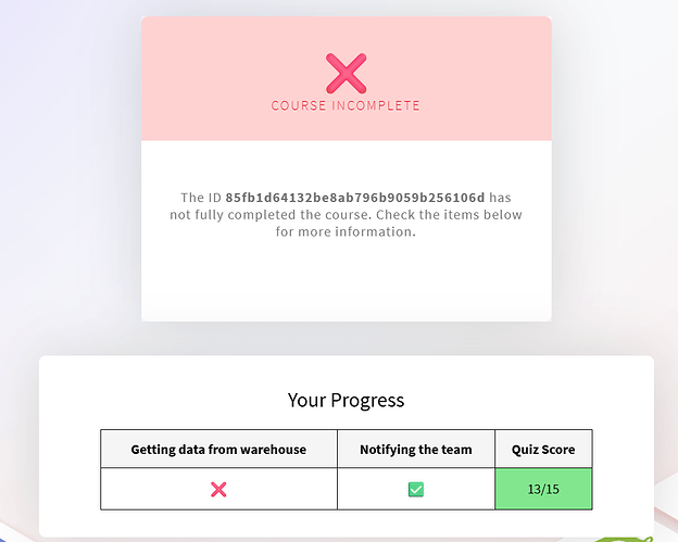

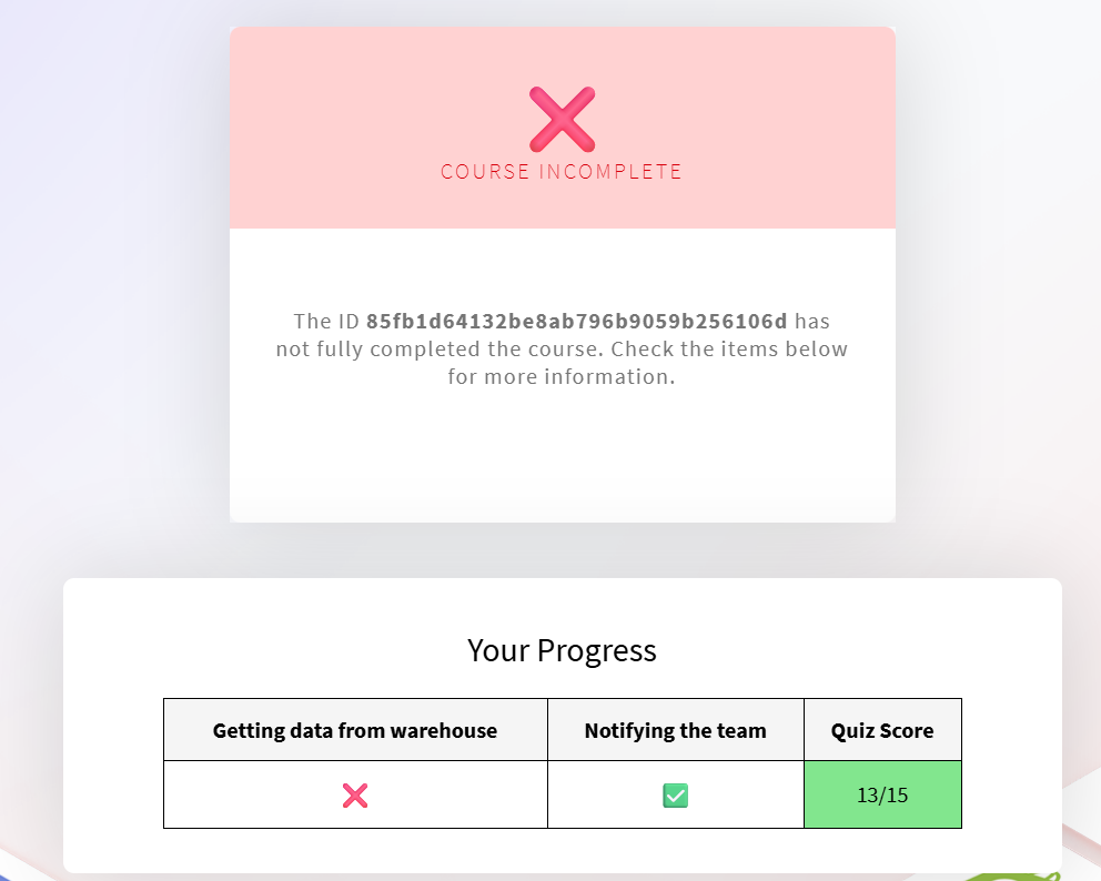

Hi Jamie,
I have finished all the steps in the Level 2 course, but I cannot complete the “Getting Data from Warehouse” section. Please help me.
Can you please run your http request again, ensure that you have your header set correctly with unique_id and your id set.

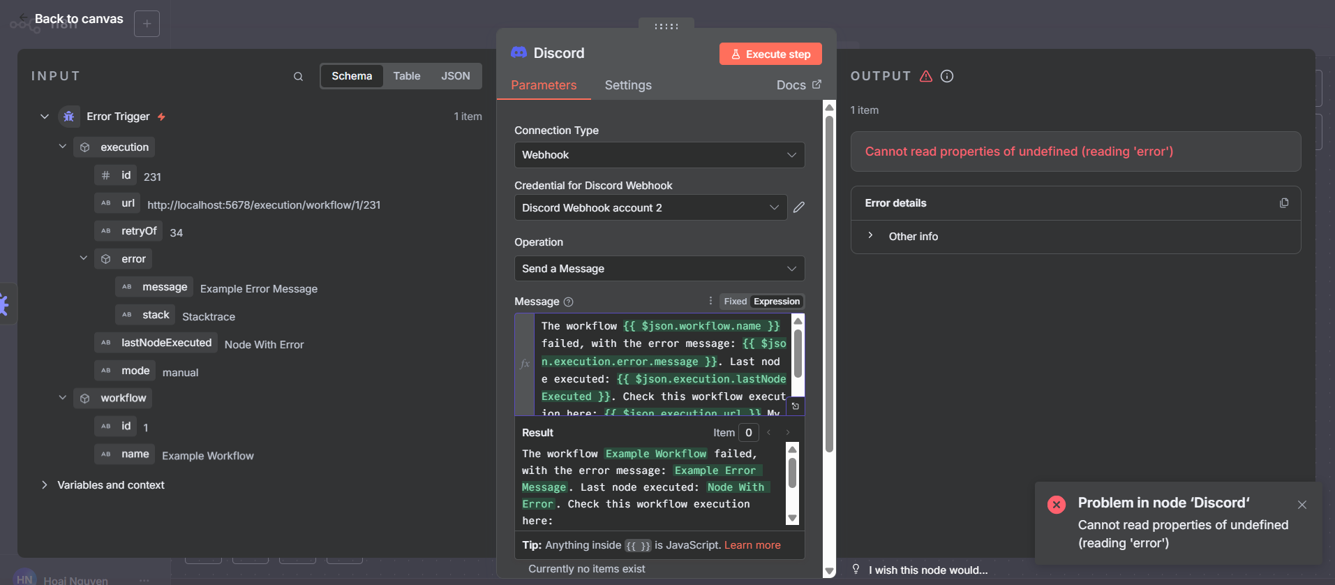

Hi Jamie,
I have checked again, and the only issue is that the workflow named “Error workflow” is not working. The error message is:
“Cannot read properties of undefined (reading ‘error’)”
However, as you can see in the picture, the error does exist. Please help me resolve this issue.
You need to re-run the workflow that gets the data from the warehouse with the level2-erp endpoint. This is the one that needs your unique_id as a header parameter.

Hi nebo how did you get the warehouse missing data. I am trying i cannot find it out

Make sure that you have the unique_id header set correctly when making the http request.
I was struggling with this as well because I was using header data from course level 1 :sweat_smile:
Changing this to the header data I received when I signed up for course level 2 fixed it.

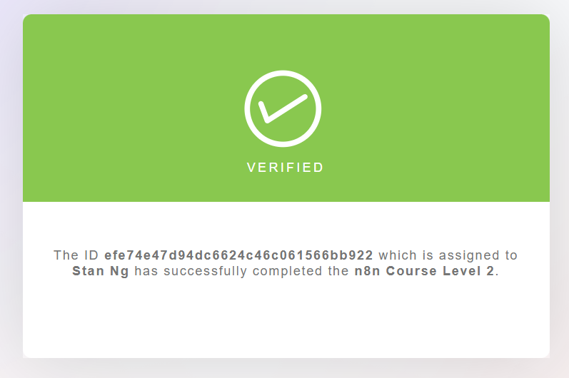

i just completed text course level 2 and get verified for completion via the link but i haven’t gotten an email notification, nor did i get a badge. Please check. My ID: efe74e47d94dc6624c46c061566bb922” .Thanks.
Hello,
I’ve checked and it looks like you’ve figured it out as the progress has been marked completed. However you signed up with a different email address than on course 1 which is why the badge isn’t being assigned. This resulted in you having two different id’s linked to 2 different email addresses.
I have merged your level 2 progress with your level 1 ID and email address. Your badge has now been assigned.

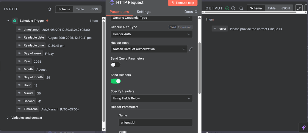

Using level 1 access email. I’m trying to use it in an HTTP Request node to fetch data, but I keep getting this error:
error: Please provide the correct Unique ID.
Here’s what I did:
  • Added a header parameterunique_id
  • Value → my actual unique_id from the email
  • Sent the request, but the server still rejects it
Here i attached the screenshot.
I had make sure everything is correct several times. But same issue. Please help me with that.
Thanks in advance :slight_smile:
@Ash_yadav I have checked and confirmed that it is working as it should.
Can you please provide your unique_id and ill check the system.
