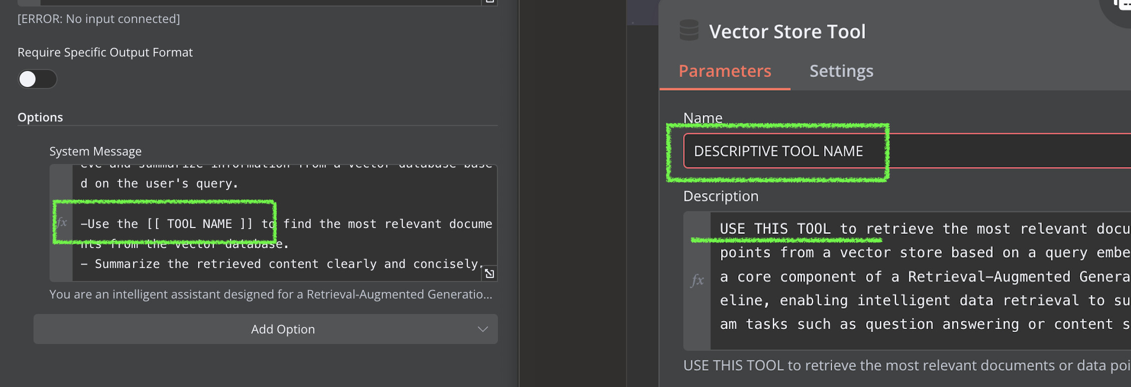

In your instructions you are telling it to “use the provided embeddings”, which is somewhat ambiguous to the AI.
n8n uses Langchain’s tool calling feature for vector store retrieval, therefore the AI needs to understand that the “embeddings” it needs to access is the tool it has to call.
So in short: you have to make your Agent instructions and the tool description more descriptive.
So something like this:
You will have to iterate over this quite a bit to get the prompt perfect so it works every time according to what you want the agent to do.
