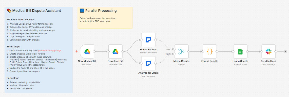

Built a workflow that runs two parallel passes on any medical bill PDF β€” one to extract all structured data, one to analyze every line item for the eight most common billing errors β€” and delivers a full dispute report in about 20 seconds.
What it does
Medical bill PDF dropped in Drive β†’ two parallel passes (structured extraction + error analysis) β†’ merges results β†’ counts issues and assigns priority β†’ logs to bill tracker β†’ posts full report to Slack
Two passes run simultaneously. Total time about 15-20 seconds.

Setup
You’ll need:
  • Google Drive (folder for medical bill PDFs)
  • Google Sheets (free)
  • n8n instance (self-hosted β€” medical bills contain PHI)
  • PDF Vector account (~6-8 credits per bill for two passes)
  • Slack (for dispute reports)
About 15 minutes to configure.
Download
Workflow JSON:
medical-bill-dispute.json
Full workflow collection:
khanhduyvt0101/workflows
Setup Guide
Step 1: Get your PDF Vector API key
Sign up at pdfvector.com β€” free plan works for testing.
Step 2: Create Drive folder and Sheet
Folder: β€œMedical Bills” β€” copy folder ID.
Sheet headers:
Provider | Patient | Date of Service | Total Billed | Insurance Paid | Patient Owes | Line Items | Issues Found | Dispute Priority | Due Date | Processed Date
Step 3: Import and configure
Download JSON β†’ n8n β†’ Import from File.
New Medical Bill (Drive Trigger):
  • Connect Google Drive (OAuth2), paste folder ID
Extract Bill Data + Analyze for Errors:
  • Both run in parallel from Download Bill
  • Add PDF Vector credential to both nodes
Log to Sheets:
  • Connect Google Sheets, paste Sheet ID
Send to Slack:
  • Connect Slack, select your billing review channel
