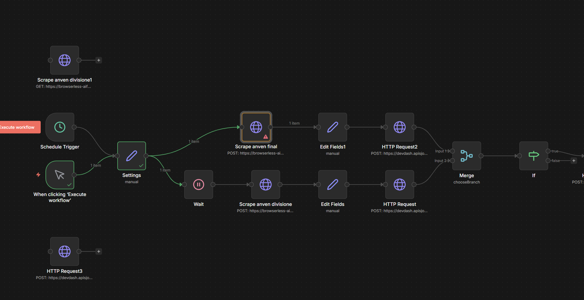

The service is receiving too many requests from you Too many requests, possible issue on schedul trigger?
I have this strange issue on schedule trigger some one can help ?
idk maybe is an issue related to HTTP REQUEST ?
after last version update the http request retunr always 429 too many request
EDIT: it seems now if i start manually the workflow return execution fail with sam error and issue but after few seconds return the data

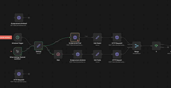

With batching or without, it doesn’t change the issue, and this issue trigger is just via a schedule trigger. Manual triggers work normally.
EDIT: cloudflare is bypassed. Browserless is set for multiple connection and concurrency session.
So what else can I try? I’m sure it’s a bug in the trigger or the HTTP node. But please tell me what else I could try.

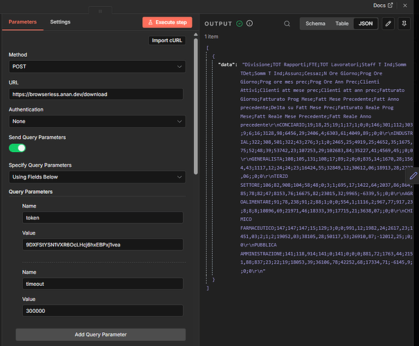

Change retry on fail not work and not help.
Thanks, but no help. I have tried with or without.

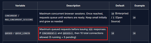

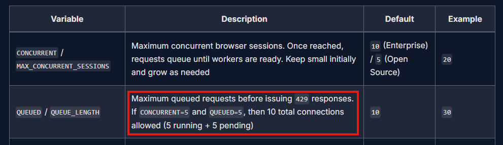

You probably need to adjust some env vars (like CONCURRENT / MAX_CONCURRENT_SESSIONS) if you’re hitting a limit on a self-hosted setup,
Check out the essential configuration here:
I need to understand why. I use Browserless in various workflows without any problems. And of course, I already set up all the environments. I’ve been using Browserless with the same installation for over a year. But thanks.
I think it’s obvious as explained here:
You are getting The service is receiving too many requests, which is explained in the Browserless documentation,
At this point, this is most likely a misconfiguration, not something related to n8n or the trigger node.
It’s simply how your logic is calling the Browserless endpoint, making too many concurrent or rapid requests without taking Browserless rate limits into account.

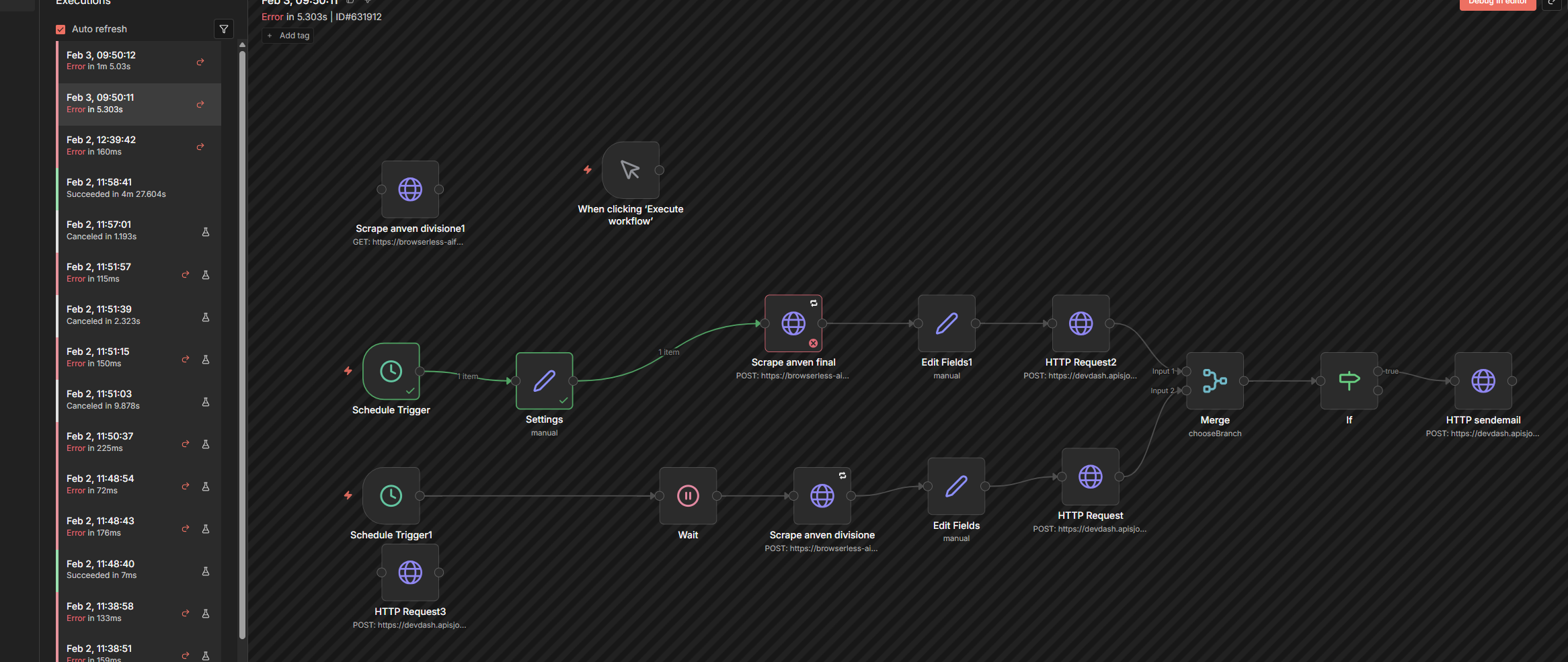

I have located the issue. is related to the server; it seems to be going full CPU or RAM and returning that error.
