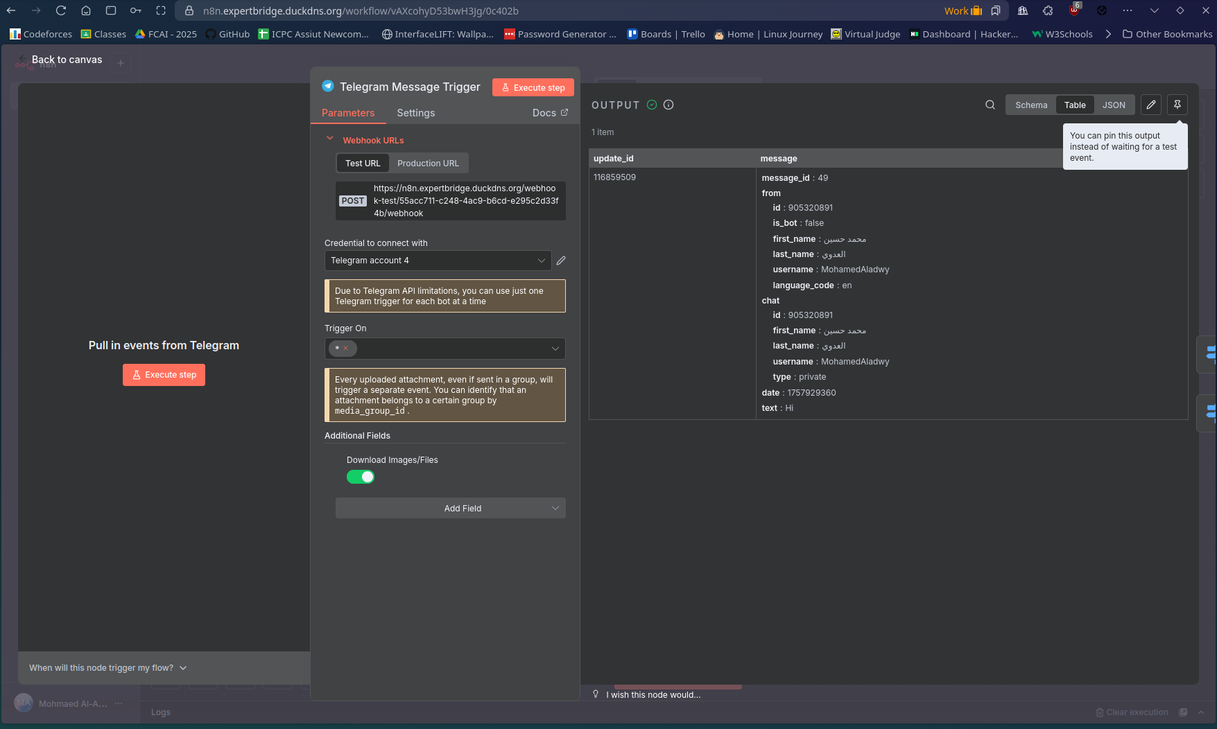

The telegram trigger is listening but when I send a message, the trigger doesn't detect anything at all!
Hi, I have an n8n self hosted on hostinger and docker-compose (self setup not the pre-configured one).
I am trying to create a telegram chatbot, and the trigger is listening correctly but when I try to send any message from the bot, the trigger doesn’t detect anything at all!
I am trying to create a telegram chatbot, and the trigger is listening correctly but when I try to send any message from the bot, the trigger doesn't detect anything at all!
No output returned at all. No message detected at all

nope, I set my dns in the environment variables to : https://n8n.expertbridge.duckdns.org
and this is my current test webhook: https://n8n.expertbridge.duckdns.org/webhook-test/{my_token}/webhook
N8N_EDITOR_BASE_URL=https://n8n.expertbridge.duckdns.org
N8N_HOST=n8n.expertbridge.duckdns.org
my problem right now is that the first node which is the trigger one is not detecting any messages at all, not with the postgresql chat memory
it worked after adding the following env var: WEBHOOK_URL to the same dns name as the edit dns and the host url
