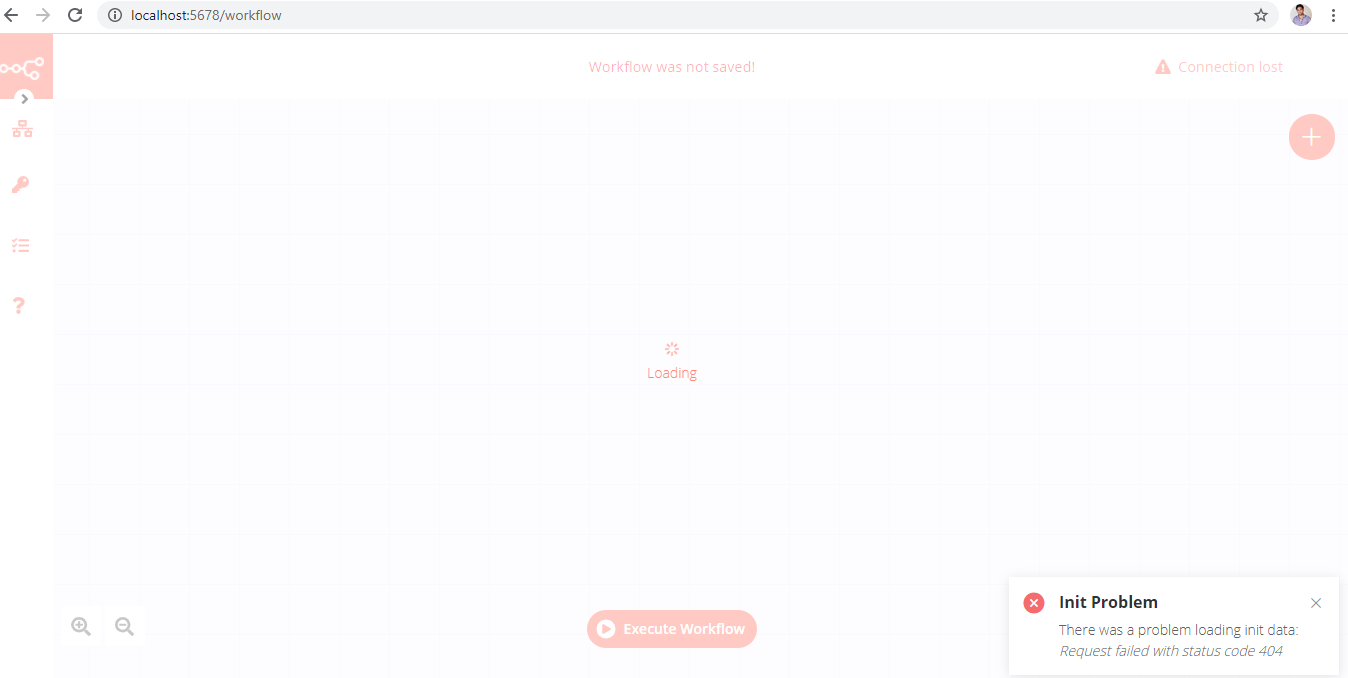

There was a problem loading init data: Request failed with status code 404
Hi everybody, i just run the editor-ui in local development and start under http://localhost:5678
i get this message and can’t figure out what i am missing, there is a screen shot i have attached also
That error message suggests that there is something wrong with the backend. So worth checking the console where you have it running.

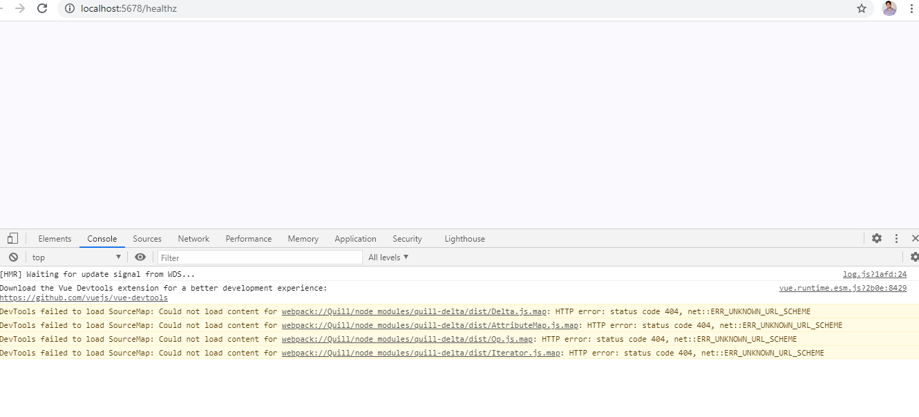

You can also check what you get when you open: http://localhost:5678/healthz
It should return {"status":"ok"}
blank , and keep in mind i just run editor-ui not any other package

  • if you say the backend is not running, then nothing would serve the page from port 5678 from your first screenshot.
  • If you run only the editor-ui in dev mode it would run on port 8080
please get attached image for detail
