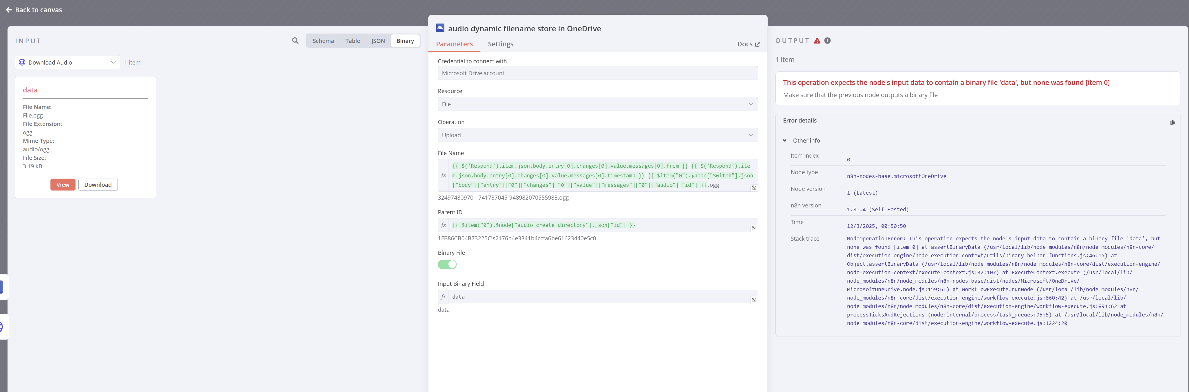

This operation expects the node's input data to contain a binary file 'data', but none was found [item 0]
  1. I am downloading an audio file from a http request (see screenshot Node below: “upload a file on OneDrive” )
  2. I want to store the audio file under a newly created directory on OneDrive
    e.g. id_customer/timestamp/audio-file-uuid.ogg
This operation expects the node’s input data to contain a binary file ‘data’, but none was found [item 0]
Make sure that the previous node outputs a binary filequote
Item Index 0
Node type n8n-nodes-base.microsoftOneDrive
Node version 1 (Latest)
n8n version 1.81.4 (Self Hosted)
Time 11/3/2025, 23:47:42
Stack trace
NodeOperationError: This operation expects the node’s input data to contain a binary file ‘data’, but none was found [item 0] at assertBinaryData (/usr/local/lib/node_modules/n8n/node_modules/n8n-core/dist/execution-engine/node-execution-context/utils/binary-helper-functions.js:46:15) at Object.assertBinaryData (/usr/local/lib/node_modules/n8n/node_modules/n8n-core/dist/execution-engine/node-execution-context/execute-context.js:32:107) at ExecuteContext.execute (/usr/local/lib/node_modules/n8n/node_modules/n8n-nodes-base/dist/nodes/Microsoft/OneDrive/MicrosoftOneDrive.node.js:159:61) at WorkflowExecute.runNode (/usr/local/lib/node_modules/n8n/node_modules/n8n-core/dist/execution-engine/workflow-execute.js:660:42) at /usr/local/lib/node_modules/n8n/node_modules/n8n-core/dist/execution-engine/workflow-execute.js:891:62 at processTicksAndRejections (node:internal/process/task_queues:95:5) at /usr/local/lib/node_modules/n8n/node_modules/n8n-core/dist/execution-engine/workflow-execute.js:1224:20

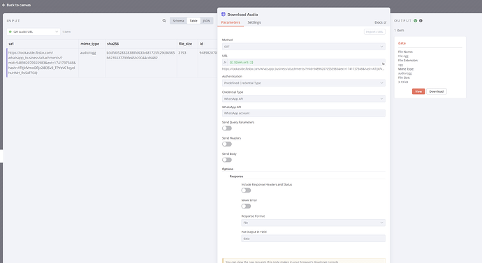

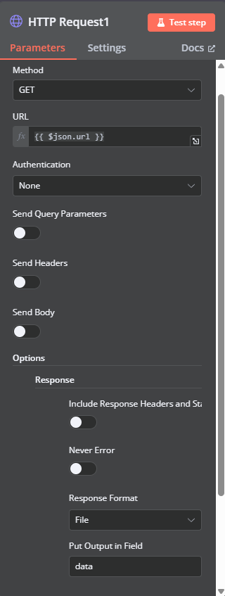

You need to add a Response option to your 'Download Audio" node and set the response format to file, and Put Output in Field to data like so:
@CameronDWills I have applied your proposal but the error remains

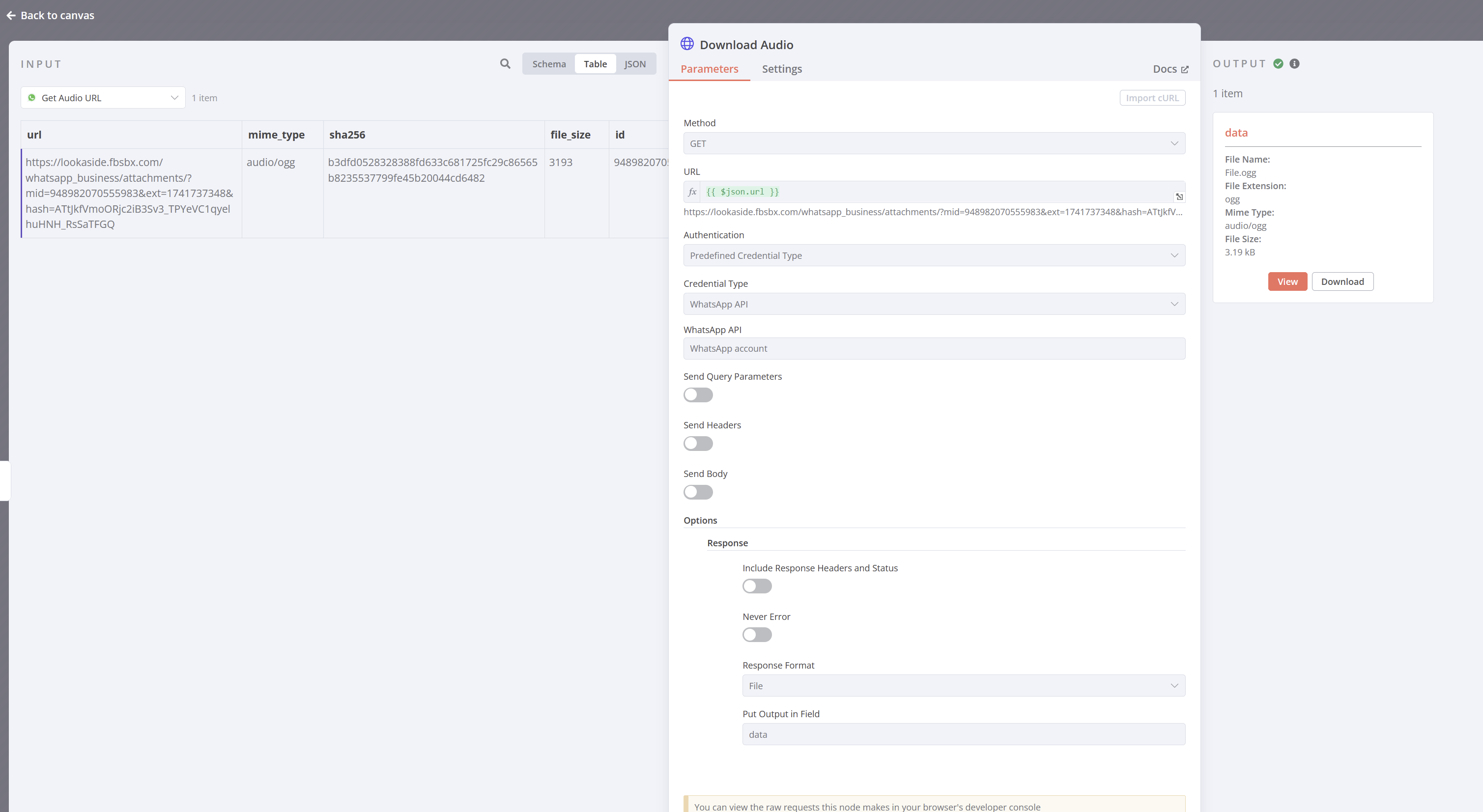

Download audio
Audio dynamic filename store in OneDrive
wiring

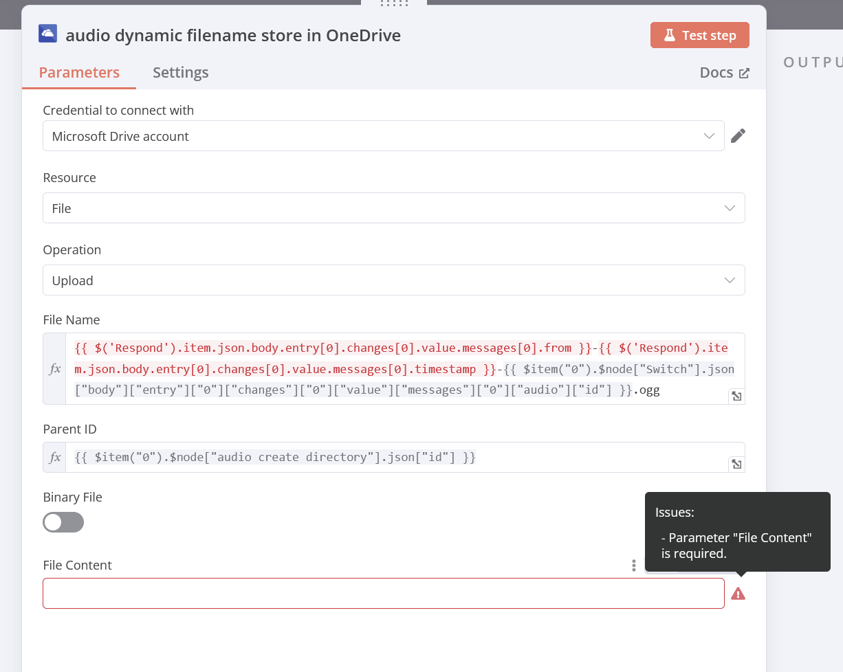

I’m not familiar with OneDrive specifically, but is there any reason you have Binary file turned on? What happens if you turn it off?
OneDrive node requires a “file content”
PS: the documentation of OneDrive components is nonexistent Microsoft OneDrive node

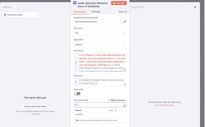

Your Download Audio node should be providing the file content, so set that File Content field to an expression and drag the file output of the Download Audio node from the input column into the File Content field, see if that works.
if the file content contains “data”, the string “data” will be stored instead of the binary file :frowning:
@CameronDWills I don’t exactly know how to do what you are asking* because the UI does NOT allow me to do such operation.
* " Set that File Content field to an expression and drag the file output of the Download Audio node"
