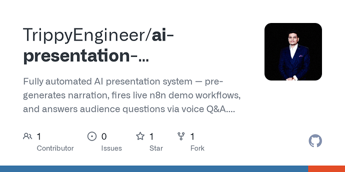

Full repo (includes the Python orchestrator that triggers these
during a live presentation):
