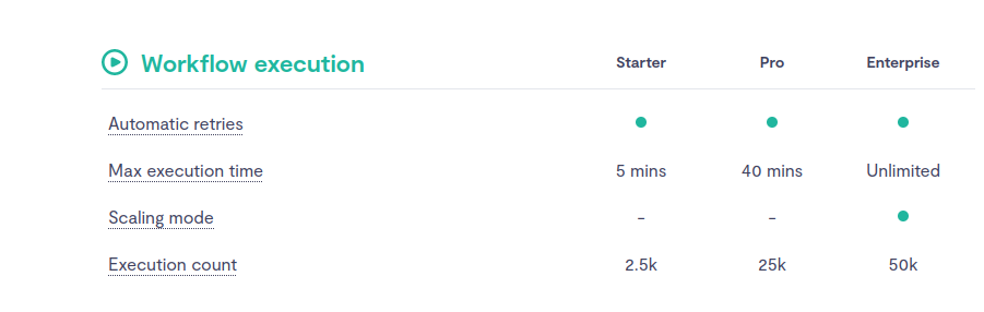

n8n does have some default timeouts on cloud - you can find these here:

I have set my scenarios to do the max 5min since I am on starter. However what occurs to n8n webhooks in cases of multiple requests incoming? Are they queued and one done after the next or what occurs?
