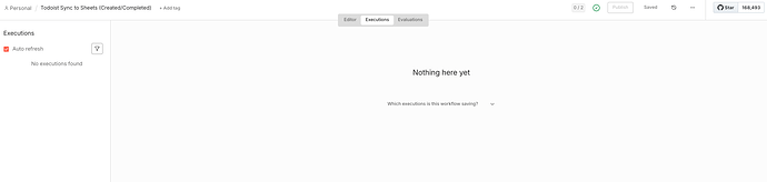

I’ve set it up using the /sync webhook on Todoist, but it seems that my webhook is never triggering even if I create or complete a new event on todoist. Am I missing something in my setup? Would appreciate any advice. Thank you!
No error message, the webhook doesn’t trigger so the flow isn’t able to start even if new events should hypothetically trigger the flow.

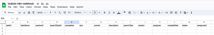

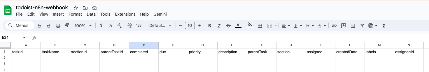

Expected output should be a new row here:

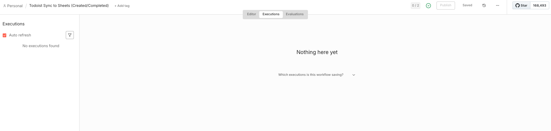

But getting no executions:
