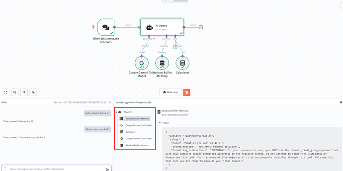

There is nothing wrong with using gemini and tools?
What is your issue with tools? Maybe the prompt of the tool can get refined a bit.
Gemini doesn’t work for me. Which model are you using?
