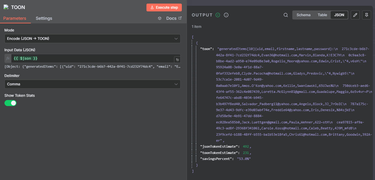

Hey, coincidentally I just built an n8n node for TOON conversion!
You can install it right now via Community Nodes in n8n:
Settings → Community Nodes → Install → @tehw0lf/n8n-nodes-toon
It’s currently pending verification, but fully functional. Supports both JSON→TOON and TOON→JSON conversion with configurable delimiters, key folding, and strict mode
parsing.
GitHub: GitHub - tehw0lf/n8n-nodes-toon: n8n node for TOON (Token-Oriented Object Notation) format conversion - bidirectional conversion between TOON and JSON with zero external dependencies
Let me know if you run into any issues, or open an issue on GitHub.

I can already use my node which implements the latest TOON standard to do that :slight_smile:
There you go :raising_hands::raising_hands::raising_hands:
