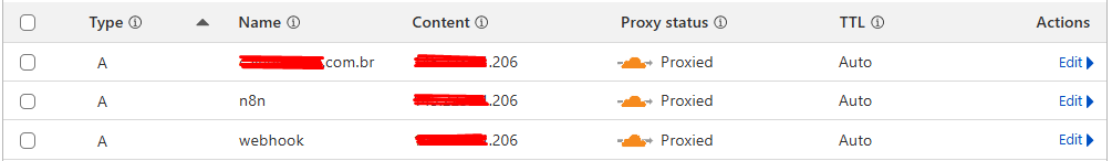

I spent a lot of time studying the documentation you sent me, and now I understand. However, the service is still going live without SSL. I connected the SSL to Cloudflare and generated the API key for the specific DNS, but I generated it for the domain and not for subdomain.domain… I don’t know if there is a problem
Cloudflare DNS Settings (all pointing to VPS ip address)
The biggest problem is that it doesn’t generate any error logs in the containers.
