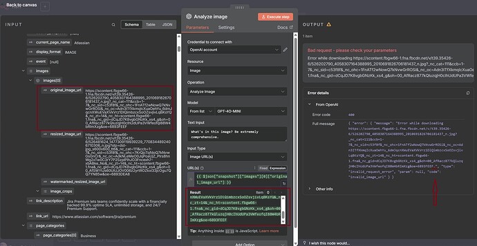

The issue I’m running into is that when this URL is passed into a text field (e.g., part of a prompt to OpenAI), the final rendered value includes a period at the end, which breaks the request. For example:
As shown in the image above, the original_image_url value in the Input matches the result of the expression {{ $json.snapshot.images[0].original_image_url }} — both are correct and do not include a period. However, the Output clearly shows a period being appended to the URL, which breaks the syntax and results in a failed request.

{ “error”: { “message”: “Error while downloading https://scontent.fbgw66-1.fna.fbcdn.net/v/t39.35426-6/526202790_4058307164388995_2010691826706181437_n.jpg?_nc_cat=111&ccb=1-7&_nc_sid=c53f8f&_nc_ohc=1FnATf2wNowQ7kNvwGrROSi&_nc_oc=Adn3ITfXkmqIcXuaOehYu_6dmJqcnXWuEVaXVkVrz1DlQimbzcxSoOZsvjivLqBKsYQ&_nc_zt=14&_nc_ht=scontent.fbgw66-1.fna&_nc_gid=dCqJD7K8vgbGNzKk_xs4_g&oh=00_AfRacz877kQluzqjH0cIhUdUPa3VWfeofqI88W4bRImXzg&oe=6893FEEF.”, “type”: “invalid_request_error”, “param”: null, “code”: “invalid_image_url” } }

Maybe download the image before the AI Agent node as binary and sent to analyze?
That’s definitely an option as workaround but RCA of actual issue is a bug?
For what’s it’s worth, I’ve created a new workflow with simply pasting a URL into the URL Value, and the same thing occurs. Something is appending a period to all requests sent to OpenAI.
OpenAI node is not liking the meta library image URL. Even though it’s entered in correctly, and request debug seems to suggest it is, in fact, being entered in correctly, there is an error. Almost wonder if Meta has blacklisted the IP range due to rate limiting or IDS.
In any event, @darrell_tw recommendation is the only option. Download binary > upload binary.
