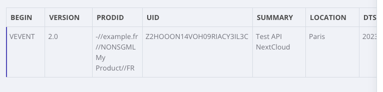

Hey @MPO,
Looking at the example you posted and the snippet from Jan it looks to work.
From here you should be able to use {{ $json["SUMMARY"] }} in the next node to use the value, If this isn’t the case could you share some screenshots maybe to show where the issue with the workflow?
Thanks @Jon and @jan
I’m not totaly in, but with the code of my workflow behind, maybe you should tell me where is my mistake ?
I got this error : ERROR: Always an Array of items has to be returned!
The issue seems to be that you said the different lines are separated by a carriage return, but in your posted example, they are separated by nothing.
