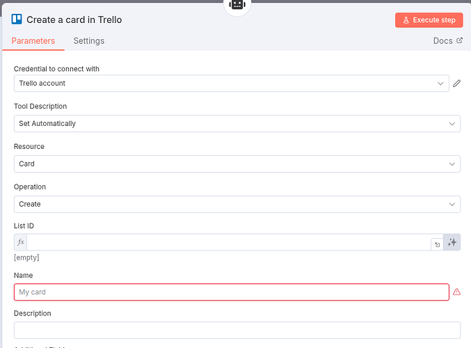

Trello tool is not showing AI button for card name and description
Hi!
When configuring a “Trello tool” node for creating a card, there is no AI button for fields “Name” and “Description”, which would be nice for an AI agent to fill the card.
The AI button is present for the card id setting (which has no sense, IMHO), and in all additional fields you add.
Any help would be appreciated! :slight_smile:
“No parameters are set up to be filled by AI. Click on the :sparkles: button next to a parameter to allow AI to set its value.”
  • n8n version: 1.102.4
  • Database: sqlite
  • n8n EXECUTIONS_PROCESS setting: default
  • Running n8n via Docker
  • Operating system: Ubuntu 22.04
You can you the {{ $fromAI('propertyName', 'propertyDescription') }} instead of the AI Button.
You can read more about it here:
Behind the scenes I believe this is exactly the same thing.
Nice workaround! Thank you very much for the tip! The problem has been solved :blush::clap:t2::clap:t2:
