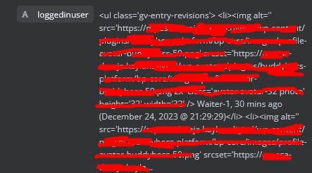

Hi, I’m trying to get data that’s in between an image URL link;
i.e I want to get “Waiter-1” which is dynamic & remove the content beginning from “<ul” all the way to “/>”
The rest of the data after “Waiter-1” is redundant as well
Any pointers?

Hi @KevinK, you can use the HTML node to extract information from an HTML document which you seem to have.
Unfortunately you have removed a lot of data from your screenshot, but if strings like Waiter-1, 30 mins ago...
are is the only actual text inside your li
elements, you can use something like this:
This example also trims the part after Waiter-1
using the JavaScript split() method, leaving you with just Waiter-1
Hope this helps!
That did the trick! Thanks
