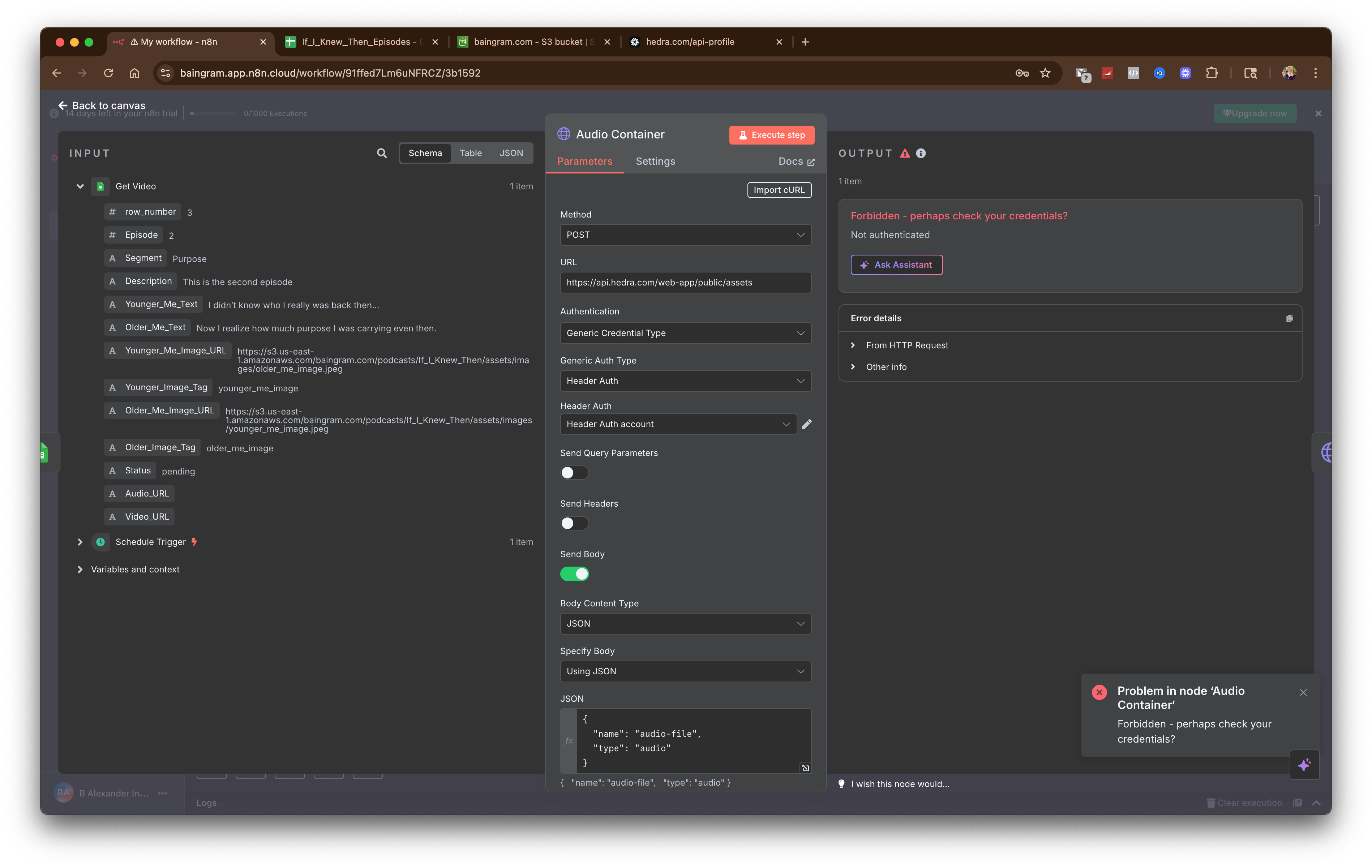

Hello, I continue to get an error when trying to create an HTTP request to get my Hedra credentials. I have several times to update my API credentials, but still get the same error. Can some please help
me resolve this? Thanks :slight_smile:

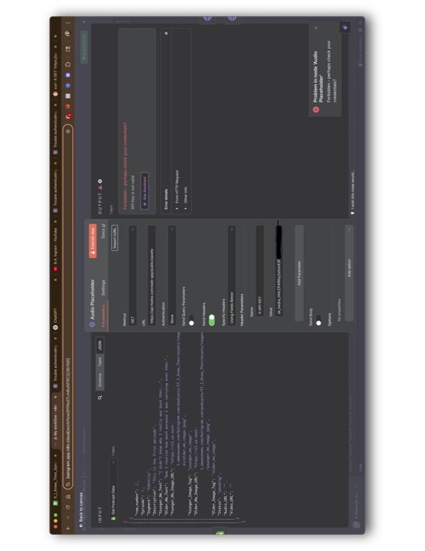

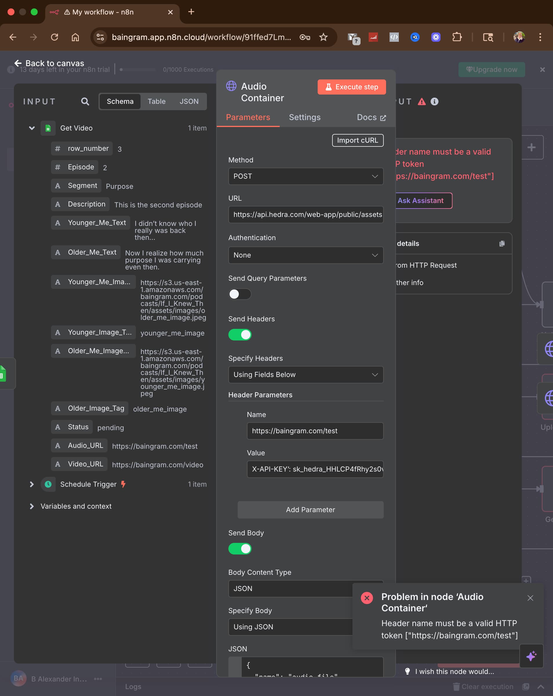

Hi Samuel and thanks for the response. I did as you suggested and removed the authorization, But, I am nor sure if I have the correct values, but here is my screenshot with the new error.
Hey @B_Alexander_Ingram
You should be able to just put x-api-key as the name, and then just paste the key as the value.

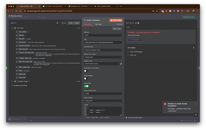

Yes, I’ve tried that as well and still get an authentication error. I’ve reached out to Hedra and haven’t gotten a response back yet. Could my inability to use the API key have anything to do with me being on the n8n trial still?
Hi,
Being on the trial is not the issue in this case.

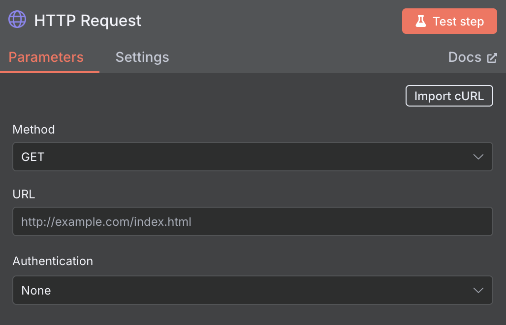

Replace the YOUR_API_KEY with your own. Then press the import cUrl in the top right and paste it.
curl -X GET 'https://api.hedra.com/web-app/public/assets' \
  -H "X-API-KEY: YOUR_API_KEY"
Hello, I’m sorry but where am I pasting this?
My bad. I should have been a bit clearer. In the HTTP node on the top right. See image below.

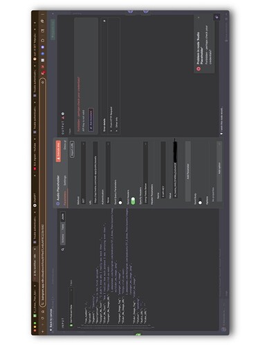

No Worries :slight_smile: thanks for the assist. I did figure where to post it. But still get the same error.
Looking at other examples this should work. Make a new http node and paste this new curl. Make sure to replace the api key on this as well.

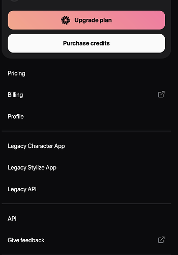

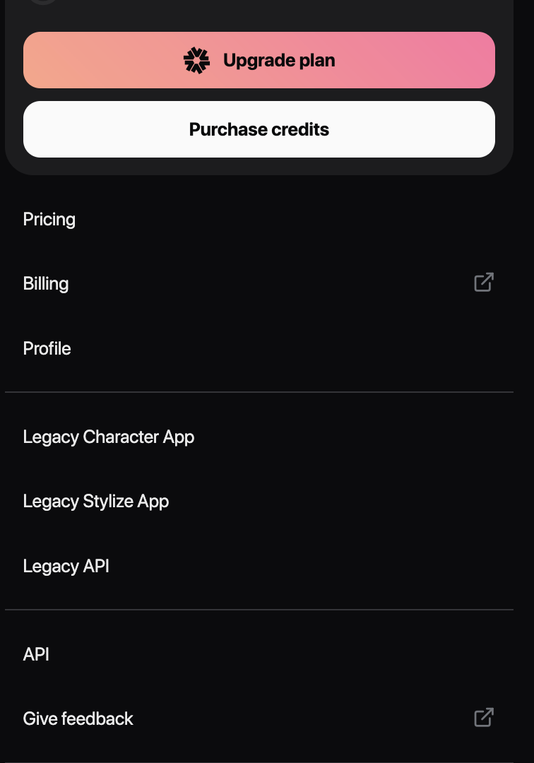

Also, I noticed there are two api versions, the legacy and the new one. Which one are you using?
The curl above is for the new one.
I clicked on the one that says API (the newest version( right above give feedback. Not the legacy. I am pretty frustrated with this entire process, becasue I can’t seem to get my request to authenticate no matter what I do. I tried using ChatGPT for help and did those steps. I also recreated just that node and still get the same error message.
