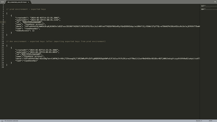

@barn4k I exported both the workflows and the credentials with n8n CLI by ID query from my prod environment, I checked and all IDs in the json files remain the same as they are in the UI.
Then i imported in my dev environment with CLI, and the IDs remain the same again. After importing I also exported the new credentials and workflows from my dev environment, checked the new json files and also there the IDs seem to have remained the same. (the credential IDs in the specific nodes that are connected to the credential)
Are there other things that play into account here?
That error means you didn’t changed the credential id for the supabaseApi when you have exported the workflow
@barn4k
Because i imported the same credentials i exported from my prod environment, the ID actually remained the same.
I verified this by exporting the newly imported keys from my dev environment after importing them.
I also verified whether the node was connected to the correct credentials, which seems to be the case as also in there the IDs remained the same after importing.
Could it have something to do with the nodesAccess key which does not seem to get imported with the credentials?
