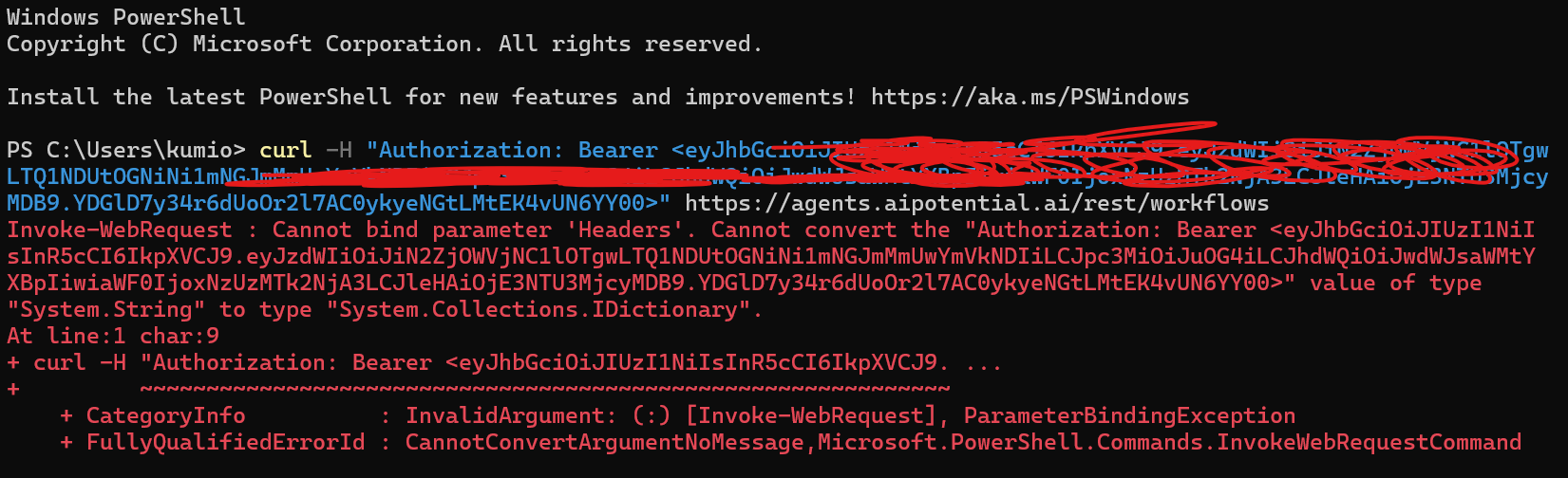

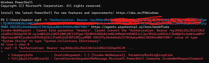

Above is the error message I got when trying to use an API key I generated in n8n to use Cursor for deployment. I’ve also had several 401 errors stating that I didn’t have permissions. This is on a self hosted iteration that is running n8n version 1.102.3. Any help with sorting permissions would be greatly appreciated as neither myself nor the owner can figure it out.
Hey @Kumi_Kemp hope all is well and welcome to the community.
Using angle brackets (<...>) around the token is incorrect unless they are part of the actual token - which they almost certainly are not. Try without it.
I got exactly the same error message back. Thank you for the advice though!
Thanks for confirming, could you try curl.exe instead of just curl?
This time it returned this error message: {“status”:“error”,“message”:“Unauthorized”}
Ok, now this is progress.
The reason for the previous error was that curl is just an alias for Invoke-WebRequest, where the parameters you passed are not recognized by the Invoke-WebRequest. curl.exe on the other hand is an actual curl binary.

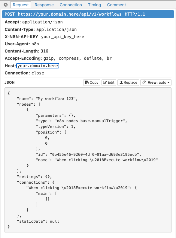

API endpoint for creating a workflow is:
/api/v1/workflow
This is how the API call request would look like to create a workflow:
The API endpoint is different, also the key is passed differently.
I don’t recognise that screen. Where did you get to that and how can I use it?
This screen is just an example of how the request would look like going to the API endpoint for creating a workflow from JSON. This is not from n8n, but rather from an intercepting proxy. This was just to illustrate the different in API endpoint I was using to create the workflow.
