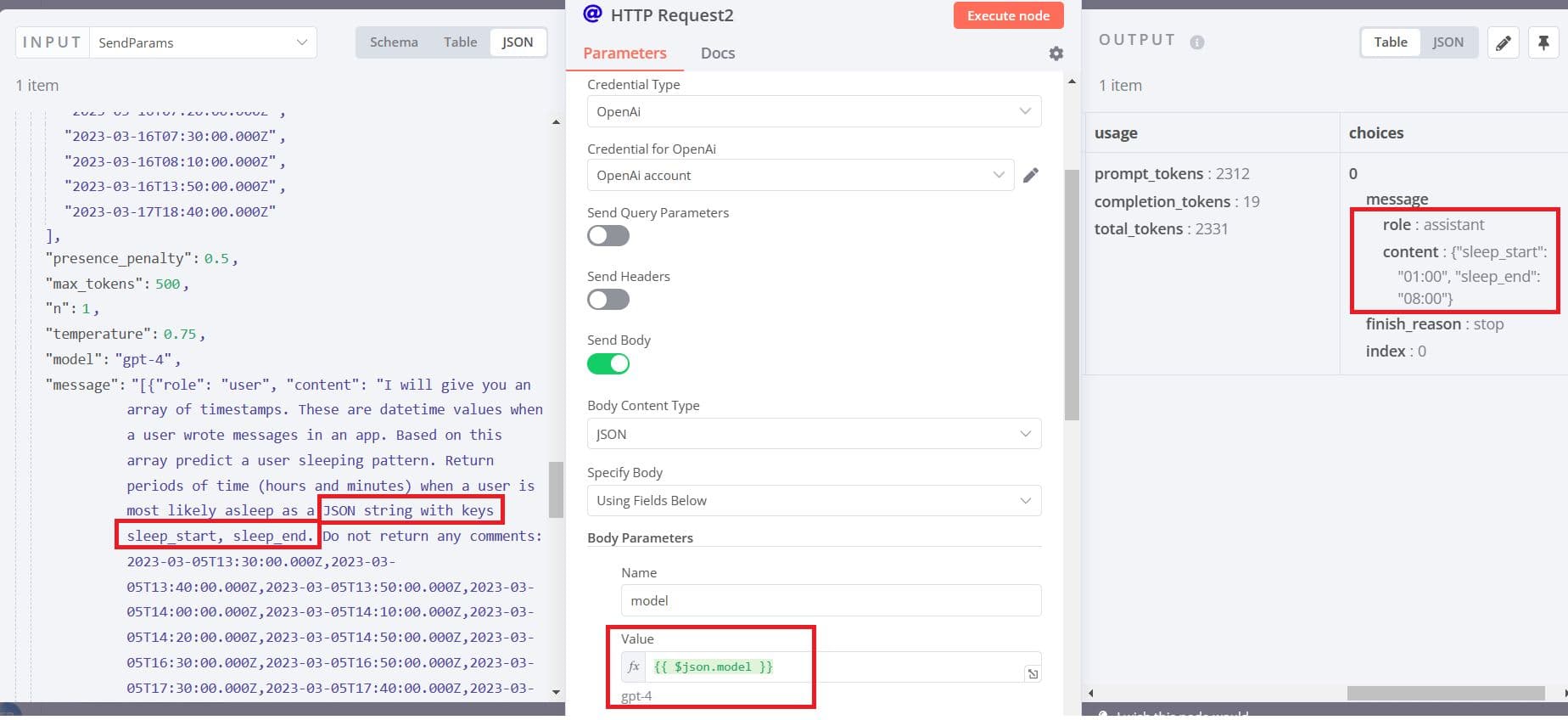

Alternative solution would be to ask GPT to put these steps in a JSON format.
So you can work with the returned object directly after using JSON.parse().
I’ve written a small example here: https://www.linkedin.com/posts/parsadanyan_machinelearning-chatgpt-gpt4-activity-7042631211659255808-SCBU
It’s a different use-case, but idea is the same. Hope I understood your request correctly
