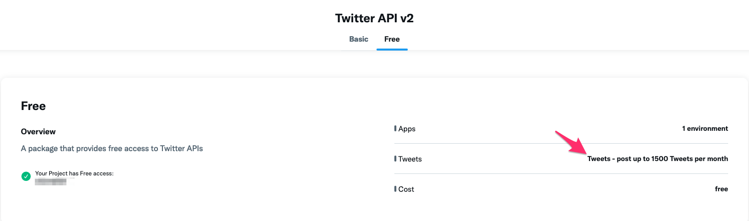

But according to the Twitter developer portal with the API free tier we are supposed to be ale to post up to thousand tweets per month
I think the error message is generic though, the free tier still enables posting or creating tweets, no ?
