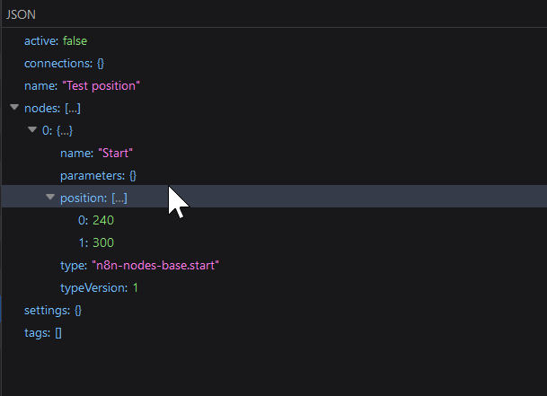

I’m on 0.172.0 and also having this issue. I don’t use n8n from touchscreen devices.
No matter what I move the Patch request sent does not include the NEW coordinates.
For example I moved the start node and saved. Position is always the same in the payload.
New workflow. Renamed and network shows a post with this position: (240,300)
Then, added another node, moved start down and saved:
Start node still shows 240,300 (but it has moved down)
