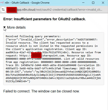

Describe the problem/error/question:
We are consistently getting errors whereby we are unable to authenticate for SharePoint within our n8n tenancy. We have fully removed the n8n enterprise app from the tenancy and have tested on separate n8n instances and are still experiencing the issue.
The app is removed from the tenancy , yet we still receive the above - any assistance will be greatly appreciated.

Short version: this isn’t an n8n bug. Azure AD is rejecting the OAuth request before n8n ever gets a valid code, so n8n shows its generic “Insufficient parameters for OAuth2 callback.” The real error is in the blob you pasted:
AADSTS650057: Invalid resource: The client has requested access to a resource which is not listed in the requested permissions in the client's application registration.
What that means
  • Your OAuth flow is hitting the v1 Microsoft endpoint and is sending a resource= for SharePoint Online (00000003-0000-0ff1-ce00-000000000000).
  • But the app registration (client ID) you’re using either:
    1. no longer exists (you said the app was removed), or
    2. exists but does not have SharePoint permissions configured/consented.
  • Because Azure returns an error instead of code/state, n8n can’t finish the handshake and shows the callback message.

Hi , okay have attempted re-creation with my colleauge and we are running into the same error again whereby it is referencing the deleted app - aad843ca-42a7-4219-a3f9-91bcf621d795
What appears to be occuring is the n8n is still trying to reference it - is there anyway to get this refreshed or deleted on the n8n side? We are using the cloud version of n8n.
Thanks
This worked. Thank you.
You’re seeing the old Client ID because some n8n credential (or node) is still using it. Azure is just echoing what n8n sends in the authorize URL. On n8n Cloud there isn’t a hidden cache you need support to purge—once you delete or reset the credential that contains the old Client ID and point your nodes to the new one, the old ID will stop appearing.
