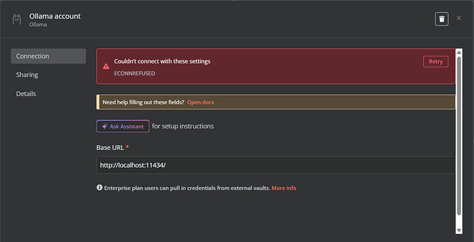

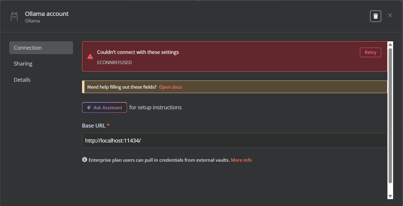

I am trying to integrate n8n with the Ollama model installed locally on my PC. However, I am unable to establish a connection. I have tried configuring the Base URL with the following values:
  • http://localhost:11434/

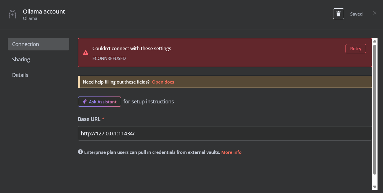

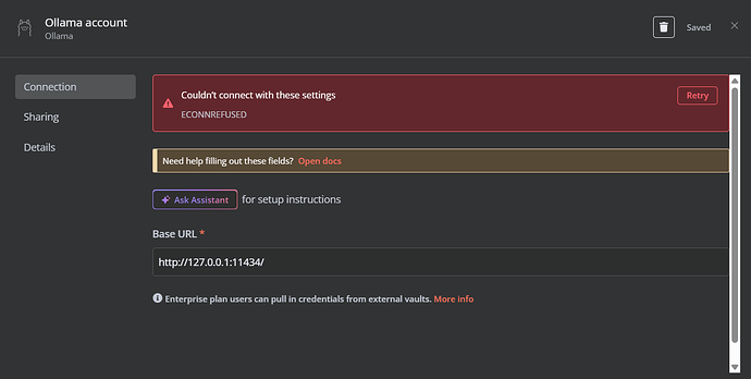

  • http://127.0.0.1:11434/
Despite multiple attempts, the connection fails, displaying an ECONNREFUSED error.
I have searched the documentation, YouTube tutorials, and online resources, but none of them mention encountering this issue. Most guides simply use one of the above URLs, and Ollama connects successfully.
I would appreciate any guidance on resolving this issue.
Couldn’t connect with these settings ECONNREFUSED
