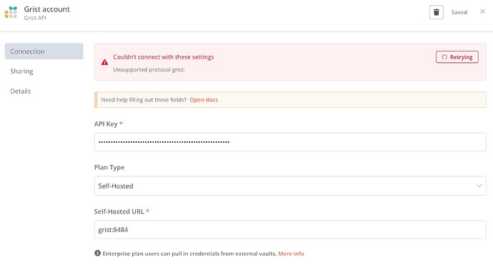

And how do you connect from n8n? With “grist:8484” as address/port?
You are using a dedicated network, so n8n should be able to connect.

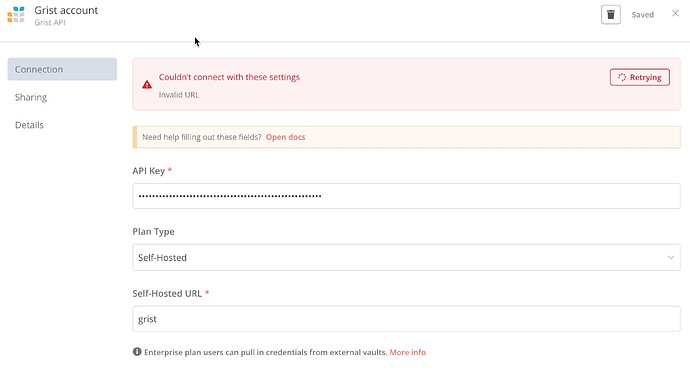

I connect using the public address, because if I try using the container name, I got an error. I show you:
If I use the public address (or the ip like http://...:8484), the connection got saved and the testing if failing with the error connect ETIMEDOUT ***.***.***.***:8484

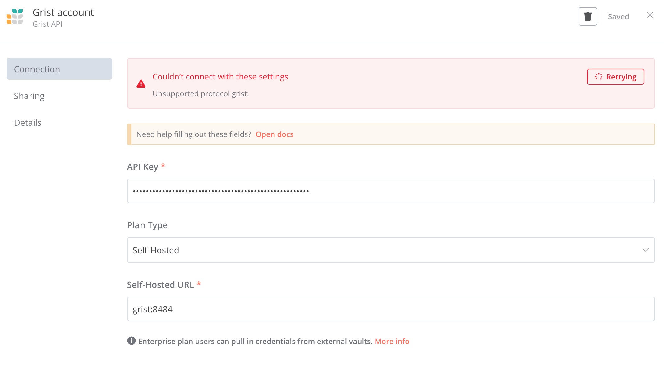

The screenshots are from n8n’s connection setup popup.
I agree, n8n should be able to resolve grist:8484, but I think it won’t even try, since it thinks grist: is the protocol.
I tried with http://grist:8484 and it says the domain is not recognized.

From n8n’s, i see the errors:
404 - {"error":"Domain not recognized: 172.18.0.3"}
Unsupported protocol grist:
404 - {"error":"Domain not recognized: grist"}

Ok.
So you need a real URL.
That needs a local DNS (or an entry in your hosts file) that points to the IP address of the server. As you use portmapping, that should work if n8n really uses that port setting, and does not default to port 80.
