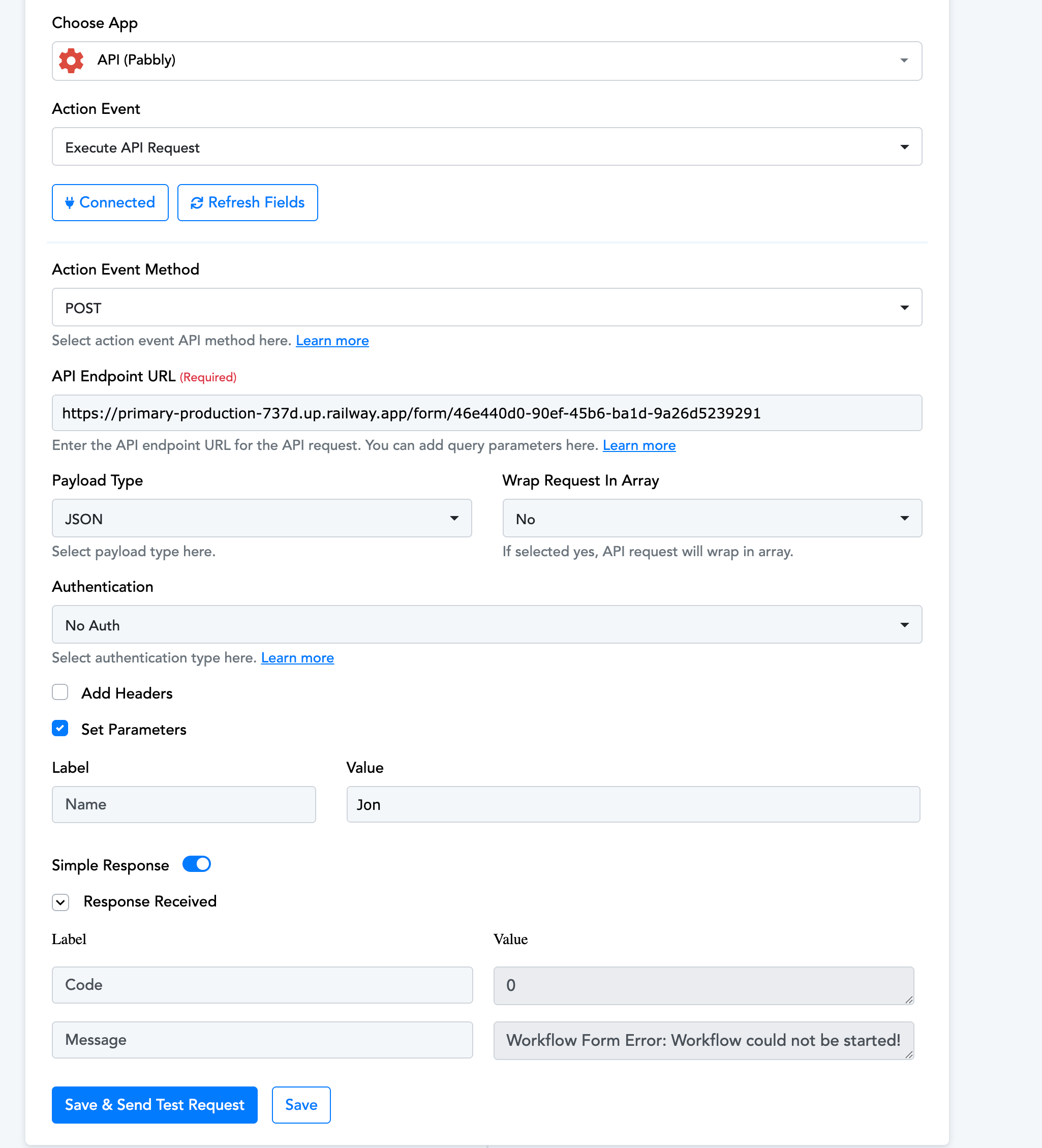

Thanks for your input @Wouter_Nigrini and @Shraddha_Singh, I think you’re both right - my guess is that the issue is with how it’s set up on Railway. I tried making it live and using the production url but it’s returning “Workflow Form Error: Workflow could not be started!”

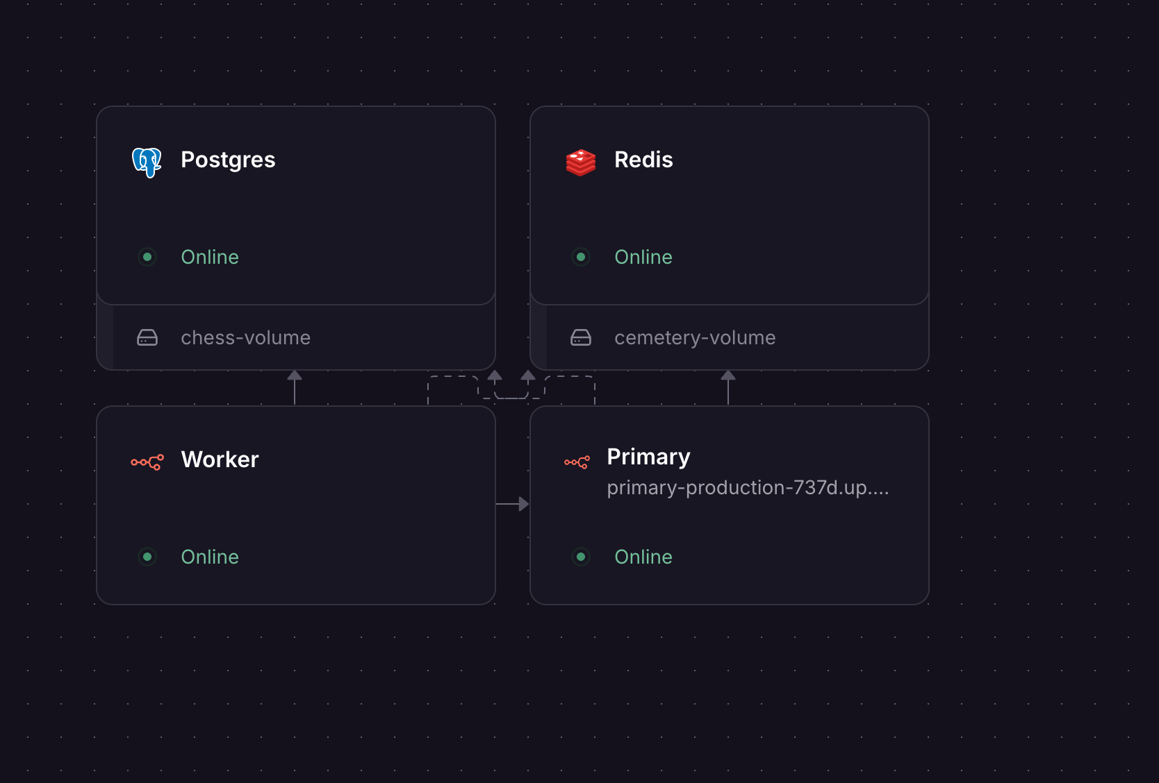

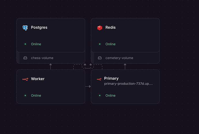

This is the current architecture for my n8n deployment on Railway:
the problem is in your worker node [intuition] , check if your worker has the same docker image/version as primary. Set EXECUTIONS_MODE=queue on both Primary and Worker
The UUID “undefined” error is a secondary issue likely caused by a corrupted session, clearing browser cookies for your n8n instance should resolve that one.

PS: after further digging i found that this is a known issue and was fixed in the release june 2025.
Use Shared Configuration Between Primary and Worker
Both services MUST use:
  • The same Docker image/n8n version
  • The same N8N_ENCRYPTION_KEY
  • The same database connection
  • The same Redis connection
  • N8N_REINSTALL_MISSING_PACKAGES=true on both Primary AND Worker
Worker Configuration
Make sure your Worker service has:
command: worker  # Not just "n8n worker"
N8N_COMMUNITY_PACKAGES_ENABLED=true
Update to the latest version as the last step.
Thanks @Shraddha_Singh - making sure the variables were the same between the nodes and redploying both seems to have worked! Really appreciate you helping me troubleshoot this!
