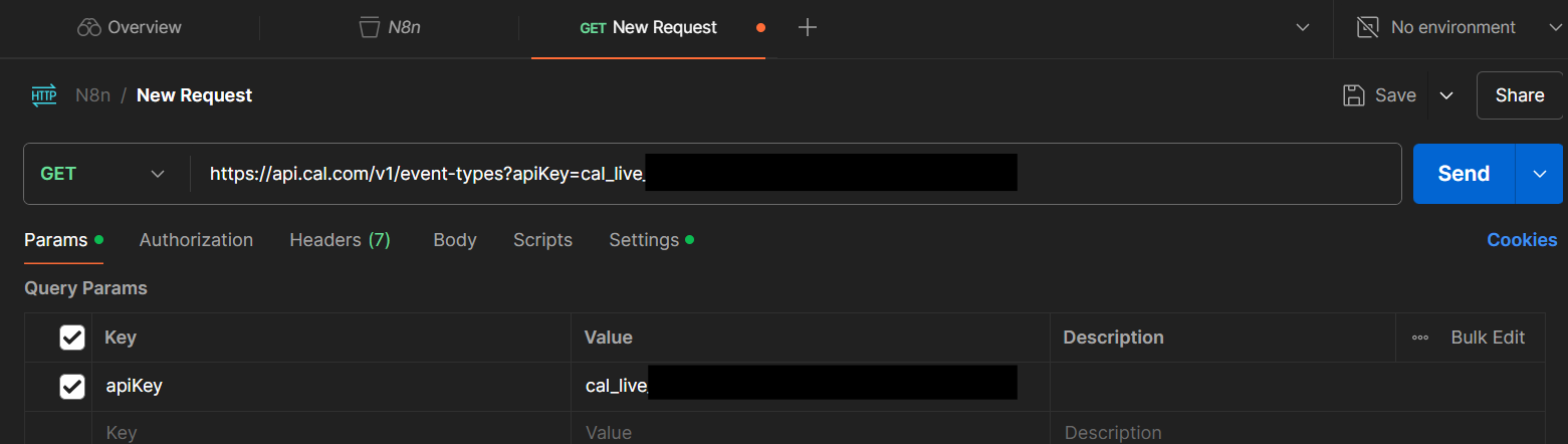

Unable to get HTTP response but able to get it using Postman for Cal Api
I am trying the following request from Postman

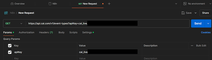

I get the following response in Postman

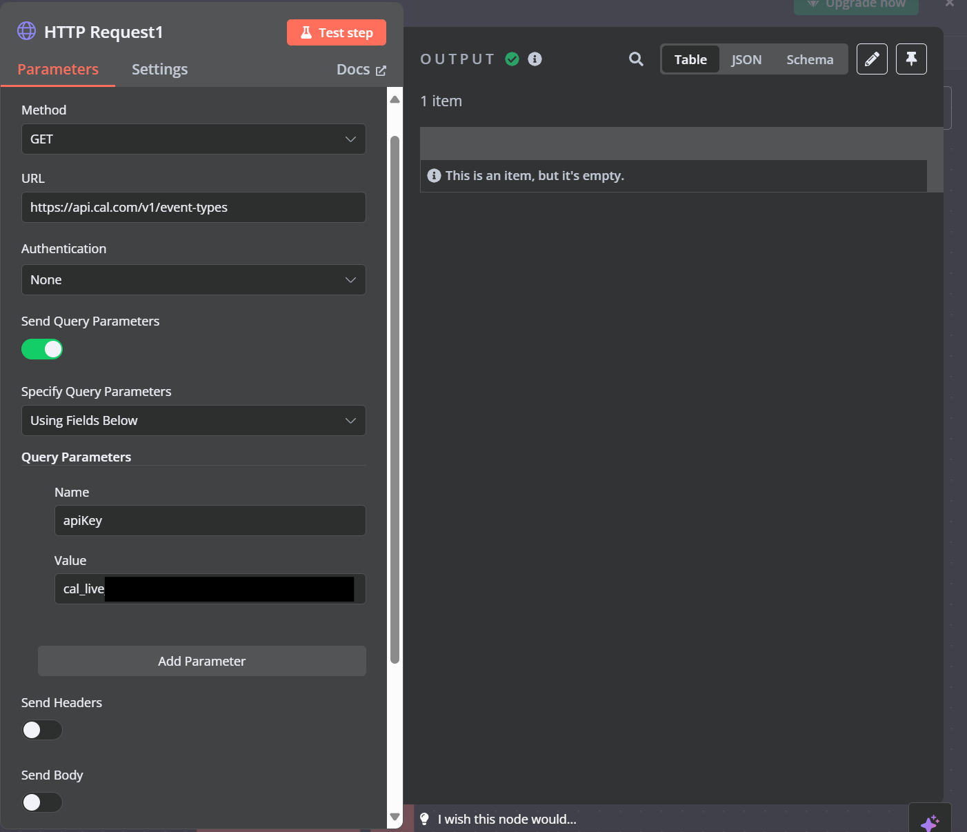

When I try to use the HTTP Node in my workflow as follows
I get empty response as seen above.
This is happening with all the various APIs of Cal, tried changing my workflow to a localhosted one as well the same issue
No error messages are seen
As seen above the output data is nothing

Solved - It was not executing any HTML request because I was not sending any item as an input. Thanks.
nodes are executed ONLY if an item input is passed, I was overlooking such a basic building block of n8n.
