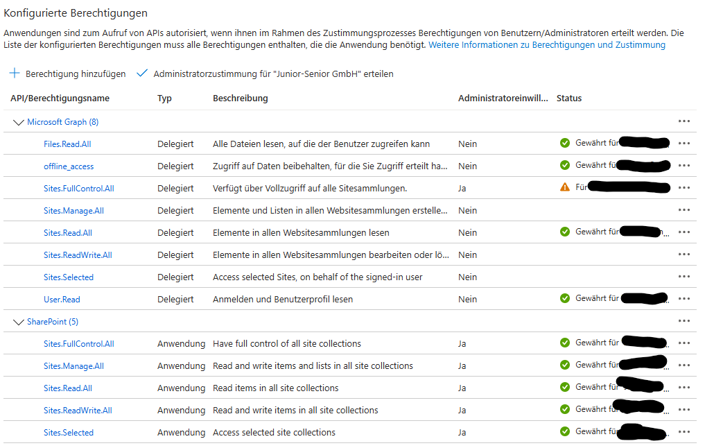

You might need to sort out whether you have the permissions set up for Application access or Delegated (single user) access? Sounds like maybe you want delegated (connecting as a specific user), but some of the permissions listed in your screenshot are “Application” permissions. Not sure how a mixture of permission types would work.
See: Understanding application-only access
This might also help: Application and delegated permissions for access tokens in the Microsoft identity platform
