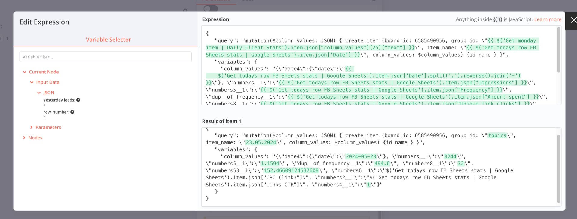

"Undefined" but should not be?
Hi, I’m experiencing a problem where a node send me an “undefined” error but whenever I refresh the page the previous node seem to trigger correctly.
Before executing the https request node, it shows green and with data. When I try to execute it turns red.

I updated and found that the “split in batches” node has been replaced and now it works.
