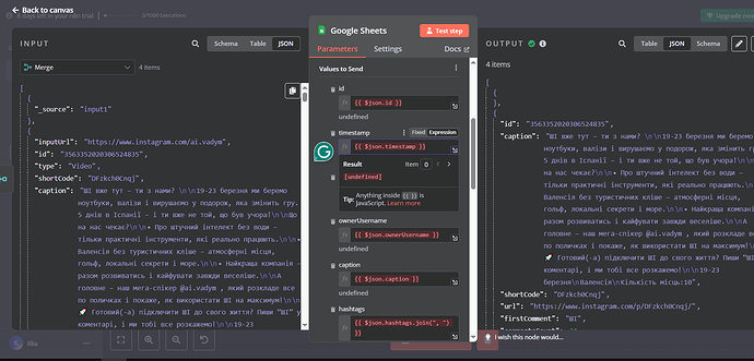

Hi community!
I have a strange issue - I use Google Spreadsheets node to insert some data there.
Even though a previous node outputs data, S/S node mapped fields return undefined output.
The interesting thing is that data still gets transferred to S/S.
Also, when I’ve build this workflow a few days ago, everything worked properly.
I’m using n8n trial period.
Thank you in advance for your help!
I can’t confirm. Perhaps if you could provide the entire workflow json and paste into the field that appears when clicking the ‘</>’ button on the forums.
But at a glance it looks like to me that potentially you are just viewing the latest item from the last node, which contains only “_source” and no other fields, which would show in the visualizer undefined, as no other values you are references exist for that item. This is most likely true as you said it still works either way.
Sure! And I think you’re right! I haven’t noticed this _source item. It appeared in the output from the Merge node. Not sure how should I avoid it. Because further in the workflow I have HTTP request node which fails because of this undefined output.
