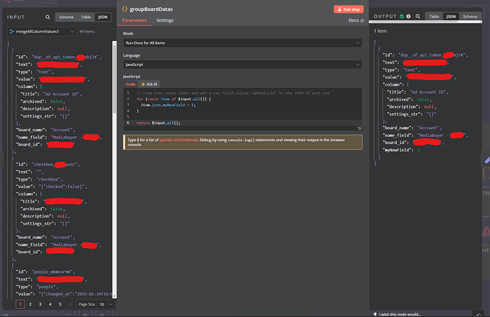

We encountered a really frustrating issue during a client-facing call. A code node that had worked perfectly around 400 times suddenly failed. After debugging, I realized the problem is with n8n’s internal function $input.all(), which, for some strange reason, only returns the first item instead of all items (as shown in the attached image).
Interestingly, if I insert an IF node (set to always true) between the last node (let’s call it outputNode, which outputs 49 items) and the code node, and reference the data like this: $("outputNode").all(), everything works fine. But without the IF node, it breaks.
Has anyone else faced this? Any idea why this is happening?

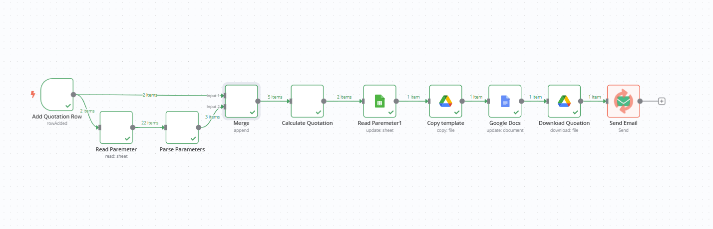

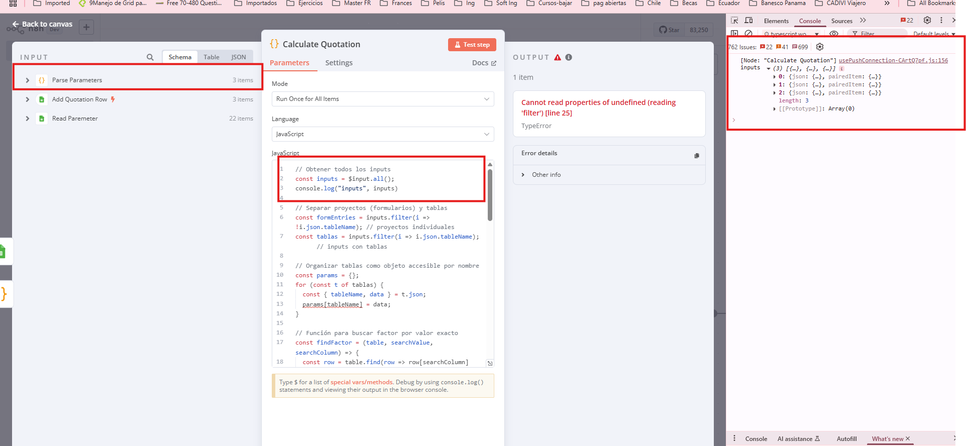

Did anyone find an answer to this issue? I have several inputs node but in the “code node” I have only the parameters for the first one , although I have used $inpu.all() to get all of them.
I would like to get the data from the Add Quotation Row node.
Then I can adjust in javascript the code.
I have just found a work around. I think it should be easier. I have used the merge node and then with code and a map function I filter the options
I was able to send the quotation as an attachment and this is calculated based on paremeters in the google sheet.
I know I can reduce the number of nodes with chagpt but I think this approach will reduce the cost.

I’m getting this same bug. There are 40 input items, but $input.all() only returns 1.
This seemed to have broken recently.
