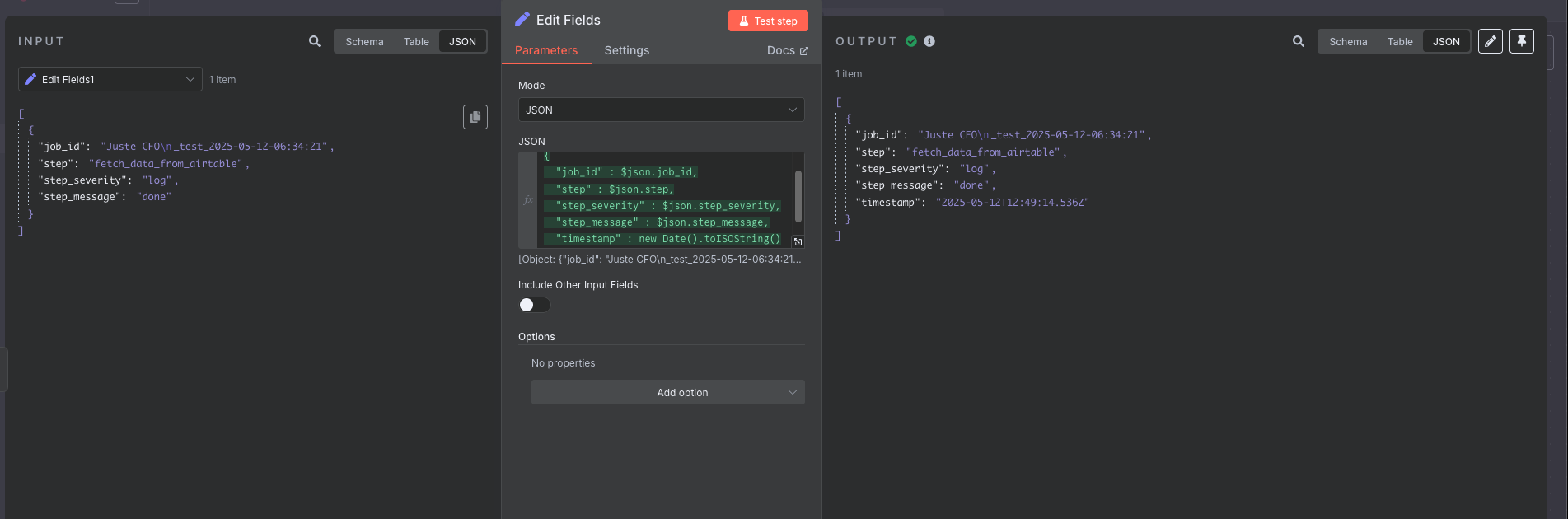

Here is a simple workflow to reproduce the bug:
The top and bottom are identical except that on the first set in the bottom “job_id” is set to “Juste CFO\n_test_2025-05-12-06:34:21” whereas it is set to “test” on the top one.
This is to illustrate a working behavior (top) vs a buggy behavior (bottom).
Is this a bug for parsing ‘\n’ ?

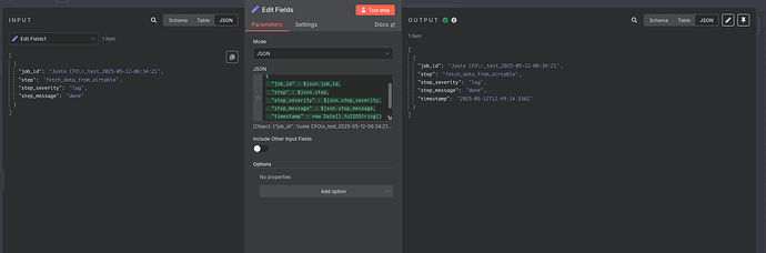

Example (the change is in the Edit Fields node in the bottom right):
The error is now gone:
